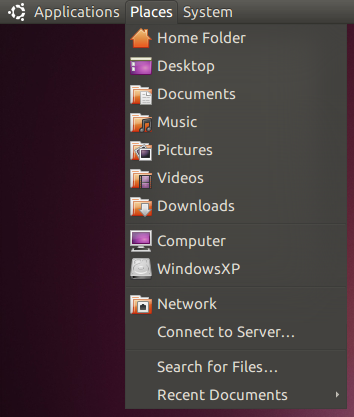

places menuLate 2009 I made the switch from Windows to Ubuntu as my primary operating system. During the first weeks of using it, I began to wonder why it would recognize my old Windows file system on the hard disk but not the BFS file systems. The partitions were correctly recognized as BeOS BFS (0xEB) and I could mount them from the command-line with mount -t befs /dev/sda5 /media/Haiku, but they didn't show up in the Places menu or elsewhere in the system.

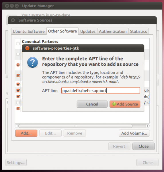

  2. In the window that opens, select the Other Software tab and click the Add... button.
  3. In the dialogue box that opens, add the following text to the text box: ppa:idefix/befs-support
  4. update manager
  5. After clicking the Add Source button and then the Close button, it will ask you to reload the information about available software.

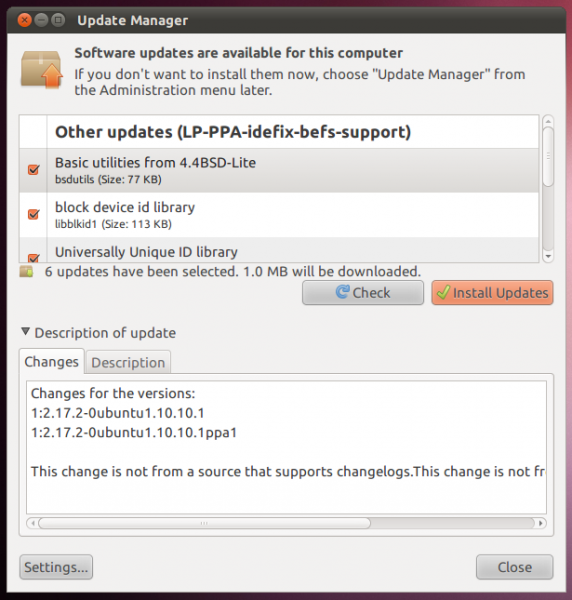

  6. Click the Reload button and after a while you will be greeted by the main window showing that there are 6 updates.
  7. Click the Install Updates button and restart the computer after it has finished updating.

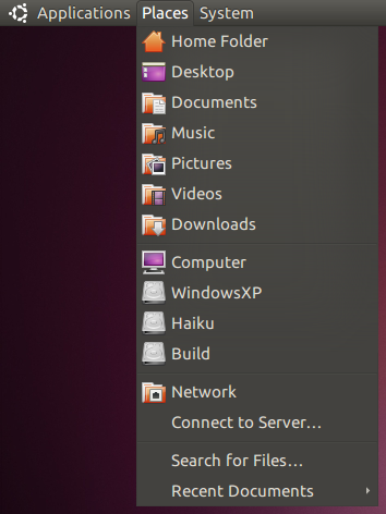

places menuIf all went well you should now see your BFS file systems in the Places menu and elsewhere in the system.
