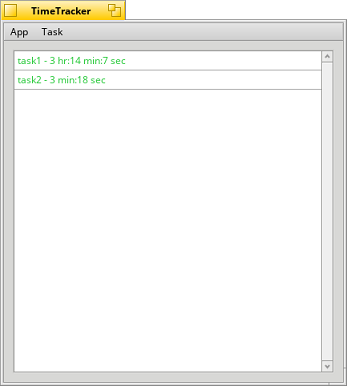

I worked on fixing style formatting issue with BDurationFormat and BTimeUnitFormat classes which are a part of Locale Kit.
BDurationFormat is used to format time intervals in a localised way i.e it takes in a time interval and converts it to a string such as "10 hour, 2 minutes, 28 seconds". There are two formatting styles supported: full name and abbreviated name. For example, for English, the full name for hour duration is "3 minutes", and the abbreviated name is "3 min".
But the abbreviated style didn't work because the BTimeUnitFormat class didn't incorporate the same. I submitted a patch to resolve this and it got successfully merged (thanks to PulkoMandy). The abbreviated style works fine now.
Screenshot of TimeTracker app showing abbreviated style:
TimeTracker

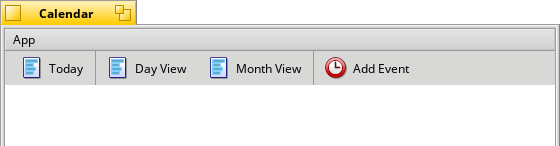

I have started experimenting with the GUI. I am currently putting my code here: AkshayAgarwal007/Calendar . I started with adding a simple toolbar to a window and adding some vector icons to the toolbar buttons.
Issues that I faced and how I resolved them:
  • I took one of the icons from here, exported it as HVIF Rdef using Icon-O-Matic, copied the hex representation into a .rdef file. Loaded the vector icon into a BBitmap object and passed it as a parameter to BToolBar::AddAction(). But the icons were not aligning properly in the toolbar buttons.
    The reason for the same was that the icons have transparent area to the right and bottom i.e they are 32x32px in size but only a 22x22px area in the corner is used.
    So I rendered the icon to a 32x32px bitmap and copied the required region in the corner to a 22x22px bitmap using BBitmap::ImportBits(). Finally, it got aligned perfectly.
  • <li> Also I wasn't the handling the BBitmap object properly. BBitmaps are
    expensive, since they create a full drawing context and thread in the
    app_server. B_BITMAP_NO_SERVER_LINK flag can be used while creating a
    BBitmap object to make it cheap to create but such a bitmap is not drawable.
    BBitmap::ImportBits() would work fine with this bitmap.<br><br> The
    following two commits can be helpful for anyone facing similar issues:
    <a href="https://github.com/AkshayAgarwal007/Calendar/commit/3f565bdeda85cb6aa07ddb255a99ad808364a41f">AkshayAgarwal007/Calendar@3f565bd</a><br>
    <a href="https://github.com/AkshayAgarwal007/Calendar/commit/8b7128f76a6cdbb51eed3701a57d7dc65424762d">AkshayAgarwal007/Calendar@8b7128f</a></li>
Stippi and PulkoMandy helped me in getting it done right.
Calendar
The icons are just placeholder icons.
