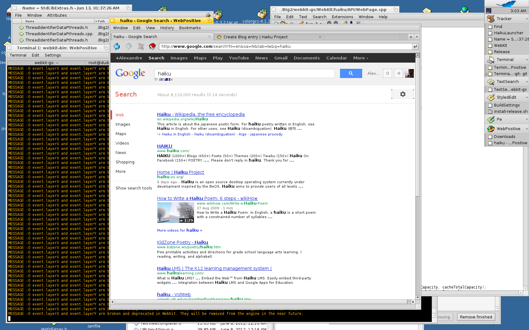

After a week of struggling with my friend the compiler, I finally managed to bring the port into a buildable state again. Porting the latest changes to libwebkit, the last of the four WebKit subcomponents (libwtf, libjavascriptcore, libwebcore, libwebkit), took me more time than I anticipated but to my great surprise, after I fixed the first runtime crash, HaikuLauncher and WebPositive would run and be almost usable. Yes, there are visual glitches, and it is quite easy to crash, but you can search google, use maps, facebook, haiku-os.org and post this blog post.
This was totally unexpected, I would have considered it normal to struggle with numerous crashes on startup, but it seems that I didn't broke that many things in the upgrade. The first thing that I noticed was the overall snappiness even in debug mode and, after looking for a simple load time benchmark, I confirmed that first impression. This benchmark shows a ~3x improvement in load time. Javascript is substantially faster too, but you know that already if you read my last post.
This is really encouraging, especially for me, as I've now got something to click and play with... after discussing with a compiler for almost a month :-)
Now the real work begins, fix all regressions and provide a solid release, one that can run the most important sites correctly. And if I've got some time left, I'll look into bringing new features and enhancements. But don't count too much on that, if prefer concentrating on a solid base for now.
Screenshot (sorry I couldn't manage to embed the image)

Could you try to enable autoscroll support http://webpositive.haiku-os.org/ticket/72
I was also wondering how much WebPositive and it's libs weigh now compared to the last available version?
Re: Unexpected
Sure i'll have a look at all the tickets at some point. Only the libs took weight (i didn't touch the browser code yet) growing from a total of 23.3MB to 27.9MB. Note that there might still be unneeded stuff in there.

Nice going aldeck! I seem to recall that webkit would be exposed through the native api as a way to render html/css etc in any application, do you know anything about this?
Re: Unexpected
Yes we would like to provide a BWebView or similar, which is actually already part of our WebKit bindings (in libwebkit.so) and used by WebPositive. We just need to be careful and design the API right so it is useful to all applications. That means that it may be "beta" for a long time and prone to changes and breakage until we totally refine it. Of course we have plenty of other WebKit API examples for other platforms that we can model, the Mac OS X one being a great example of one used extensively in various applications.
But I can safely say the Haiku API probably won't be "official and public" until after R1.

This is great work. I think we kind-of forgot about Web Positive because it appeared to work for the most part. These performance increases sound like experience will almost be night and day.
I am unclear on whether the updated WebKit will also necessarily bring more HTML5 features. From what I understand each feature has to basically enabled and mapped down into Haiku (sometimes).
Re: Unexpected
Pretty much, but this work lays the groundwork for us doing that much easier since we will be dealing with the latest and greatest WebKit, not the one from two years ago (or however old it was.) Certainly things like HTML5 audio and video will require us to add Haiku-specific code, but there should also be a lot of stuff we will get for free. But there is still plenty of work to be done in the Haiku platform code to support all of WebKit's features.
