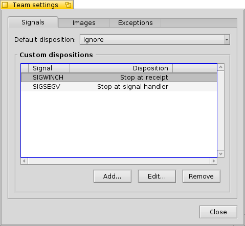

The newly added support allows the debugger to be notified of signals prior to them being handed off to the application, consequently making such situations much more straightforward to analyze. This support is customizable, since not all signals are necessarily of interest. To go with the additional UI to handle the aforementioned configuration, some rearranging has been done to make things more accessible. Some of the advanced options that were previously hidden behind the "Configure break conditions" button in the Breakpoints tab have now been relocated to a general team-wide settings window, accessible from the Teams menu, along with the newly added UI for signals, as can be seen below:
Three possible dispositions can be configured for how a signal is dealt with by the debugger:
- Ignore - This is essentially the behavior that would occur prior to support being added, where the debugger does nothing with the signal and simply allows the application to continue execution as usual.
- Stop at receipt - In this instance, the thread which receives the signal halts execution immediately. The signal number and description that caused the halt will be listed in the stop reason column of the threads view.
- Stop at signal handler If this option is selected, and the application has in fact installed a signal handler for the signal in question, then execution will be allowed to continue until that handler is reached. Note that if no handler has been installed, the debugger will fall back to the stop at receipt behavior. Also, a caveat to be aware of is that nothing in the APIs prevents an application from installing an invalid handler pointer, in which case the behavior is undefined.
The drop down seen at the top allows a global default to be set for how signals are handled, while the lower half allows custom overrides for specific signals. This is necessary because, depending on the nature of the application, there may be many signals in play, most of which aren't of interest for the situation being debugged. Such a case is illustrated in this screenshot, where the default is to ignore signals, but with two signals specified as being handled differently. The inverse is also possible, where one can set all signals to halt execution by default, but ignore a specific subset.
