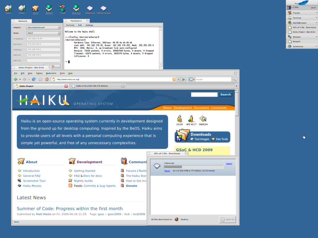

Screenshot of working WiFi prototype
Today I fiddled out the last hurdle on getting my WiFi-card up and running. It only connects to unprotected open wireless LANs, because there is no configuring mechanism implemented yet. Though it is far away from completeness.
On the screenshot, you see Firefox surfing www.haiku-os.org and downloading a 100 MiB file from my ftp server in parallel. The terminal is showing the result of the ifconfig command for my WiFi-card.
