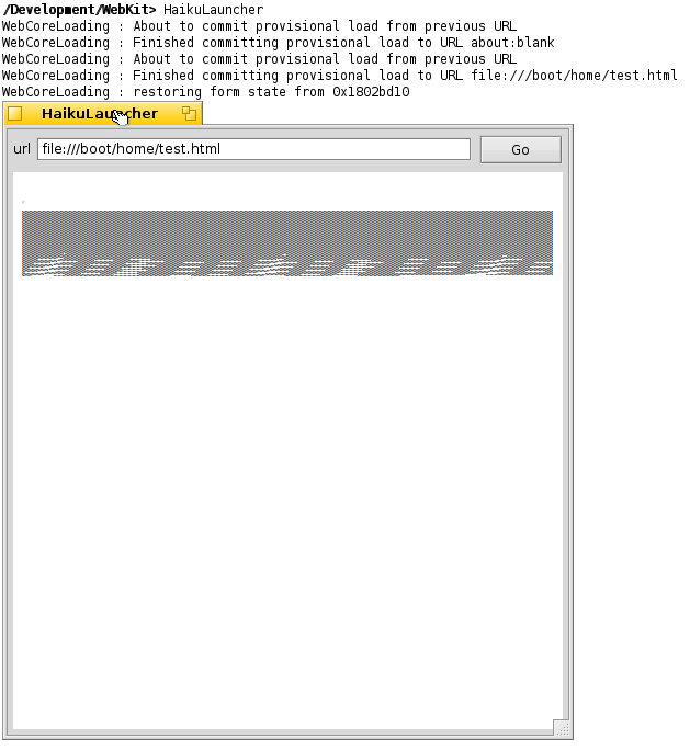

First screenshot of HaikuLauncher.: Screenshot of the first start of HaikuLauncherHaikuLauncher:
First start.
I do not know if you remember, but in my last blog post I just finished building WebKit. And in fact it was just the beginning of the beginning. To test WebKit we have a “browser-shell” named HaikuLauncher that Ryan did 2 years ago. So my first step was to make this working. And it was not as simple as it sounds. As I said many parts of the WebKit code changed, so I had to adapt these parts of our port just to run HaikuLauncher. As a great optimist, I assumed that, once HaikuLauncher started, the work was completed. Actually I was a bit too optimist. Near is a screenshot of what I got with a really simple html page (a h1, a hr and an image). With some little enhancements on the content size I got the hr to display correctly. But I did not finish my sentences.

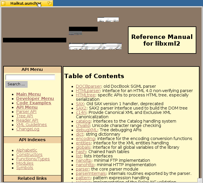

WebKit font handling, at last something correct.Font handling:
At last something correct.
My first task was to understand what I did not get any text (even texts in a paragraph tag did not displayed). During the correction process I got some overlapping, some great issues with the font width etc… In short, it was not a funny task to correct this problem. I finally succeed, and now our port displays the text without any problem ( in fact any problem we know for the moment ). As you may notice on the screenshot, the css was in good shape. And indeed I never ran into trouble with it.

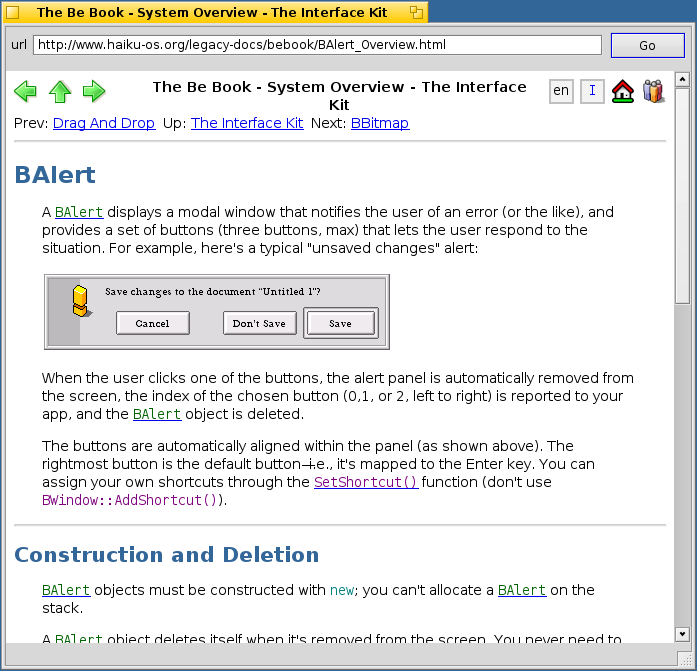

Extract of the BeBook.Extract of the BeBook. In the current state, our port can be used to navigate the web, but with some restrictions:
  • We have an issue with javascript, or rather, with pages which contains javascript. It is impossible to navigate these pages.
  • The scrolling is not correctly handled. Even if you can see the scroll bars in the screenshots, they do not work properly.
  • No JPEG images support, but who uses JPEG? Erm… Actually we should use Haiku translators to manage images, but that is not the case for the moment. And as there is no libjpeg in Haiku, there is no JPEG support.
Of course we are working on these issues to provide, as soon as possible, a fully working version of WebKit.
