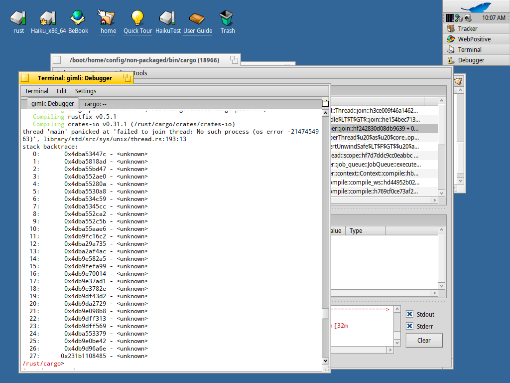

In order to find out more about what exactly leads to the failure, I decided to rerun the command with the RUST_BACKTRACE=full
environment variable, in order to use Rust’s internal stack trace mechanism. That lead to the following result:

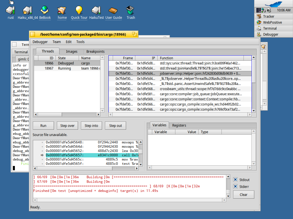

Unfortunately, it is not very useful and has been broken for a while. Let’s see if our friend Debugger can help us get a stack trace.
This gives us a more useful stack trace. The issue seems to be in threads that were created (and then joined) by the jobserver crate. This crate implements a method pioneered by make
to allow a “form of parallelism limiting across process boundaries”. I added more debug output to the code, and I found that for each crate that cargo has to build, it spawns a helper thread. Then at the end of the build process, cargo
would try to join all the helper threads, failing on the first helper thread that was joined.
