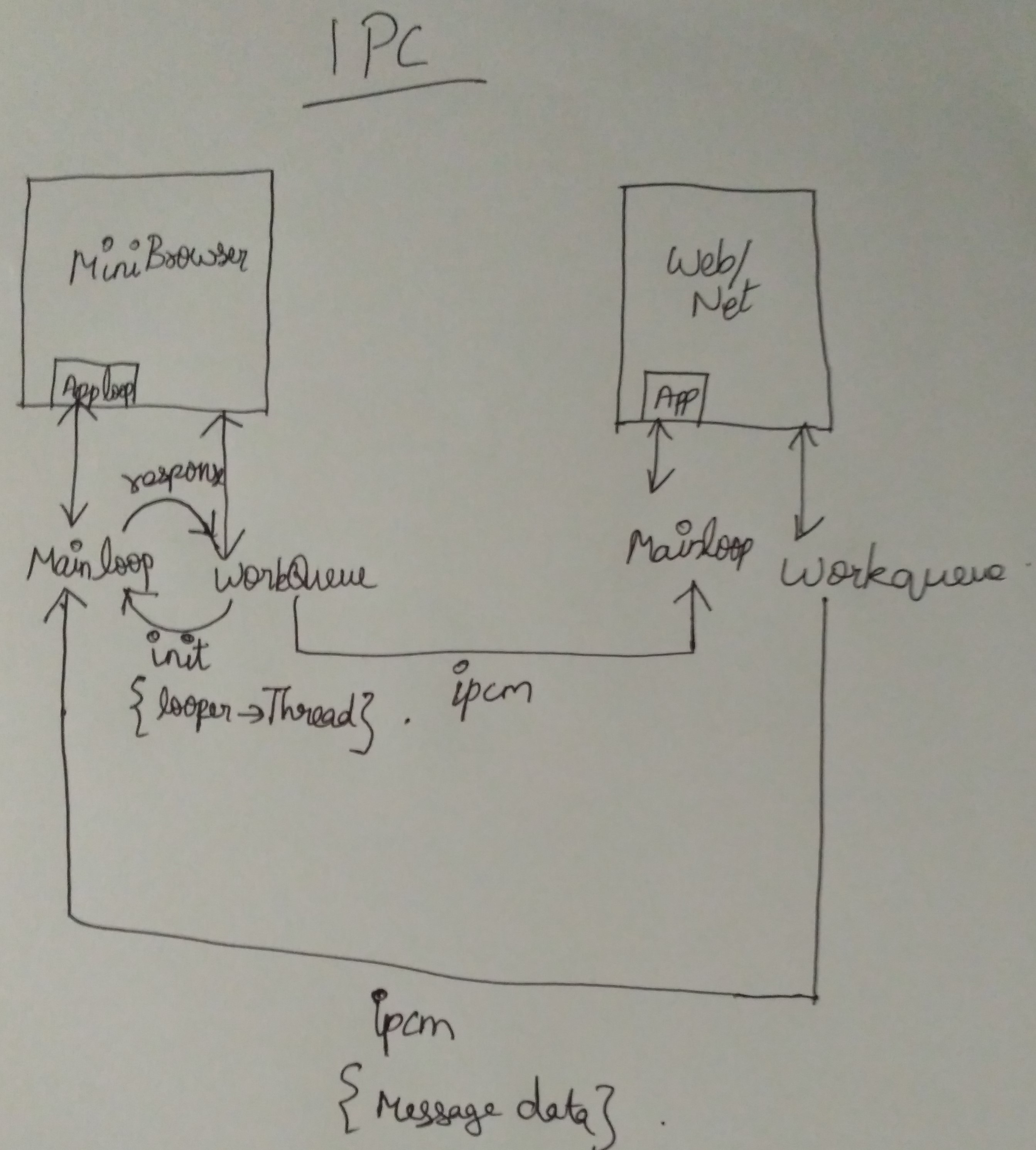

- Yes we had to make the Processes talk with each other. So we started fixing the IPC with our native messaging framework. The handlers were attached to the MainLoop(attached to the application’s main looper) and things started to talk for quite a while until we hit on a fact that JS execution may block the MainLoop so its evil to attach it there.
Phew an alternate way to make them talkπ€
- As Attaching the handlers that receive function calls from other messages to the MainLoop didn’t turn out to be expected. We had to attach it to the WorkQueue’s Looper just like all the other platforms. So currently we have to do extra work to send message from application’s looper to WorkQueue’s looper. Take a look of the rough schema I made for the above plan βπ.
