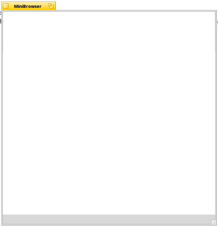

A Minibrowser to satisfy our needs
The compilation is done what now? A browser to test our stuff (even if we have nothing). I stole the design from HaikuLauncher( a testing browser that uses webkitlegacy ). Was just a basic browser with messed up schema but felt so happy that I have accomplished something.
https://github.com/RAJAGOPALAN-GANGADHARAN/webkit/commit/ba318c89f7ebd39a28436b7ca343589dc29da2a5

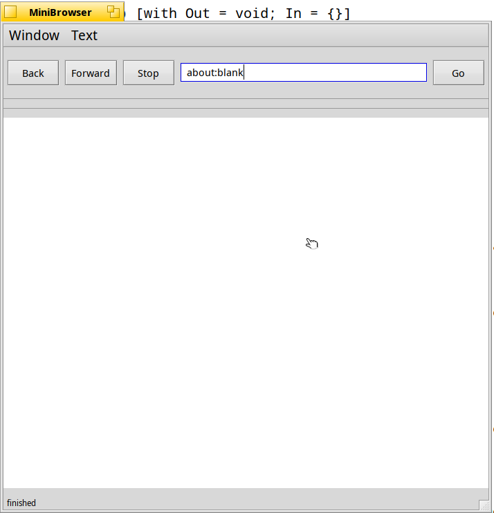

This is the part where it loads “blank url”.
https://github.com/RAJAGOPALAN-GANGADHARAN/webkit/commit/db73dbafe380287638149c9c7c95ef2ee26fb581

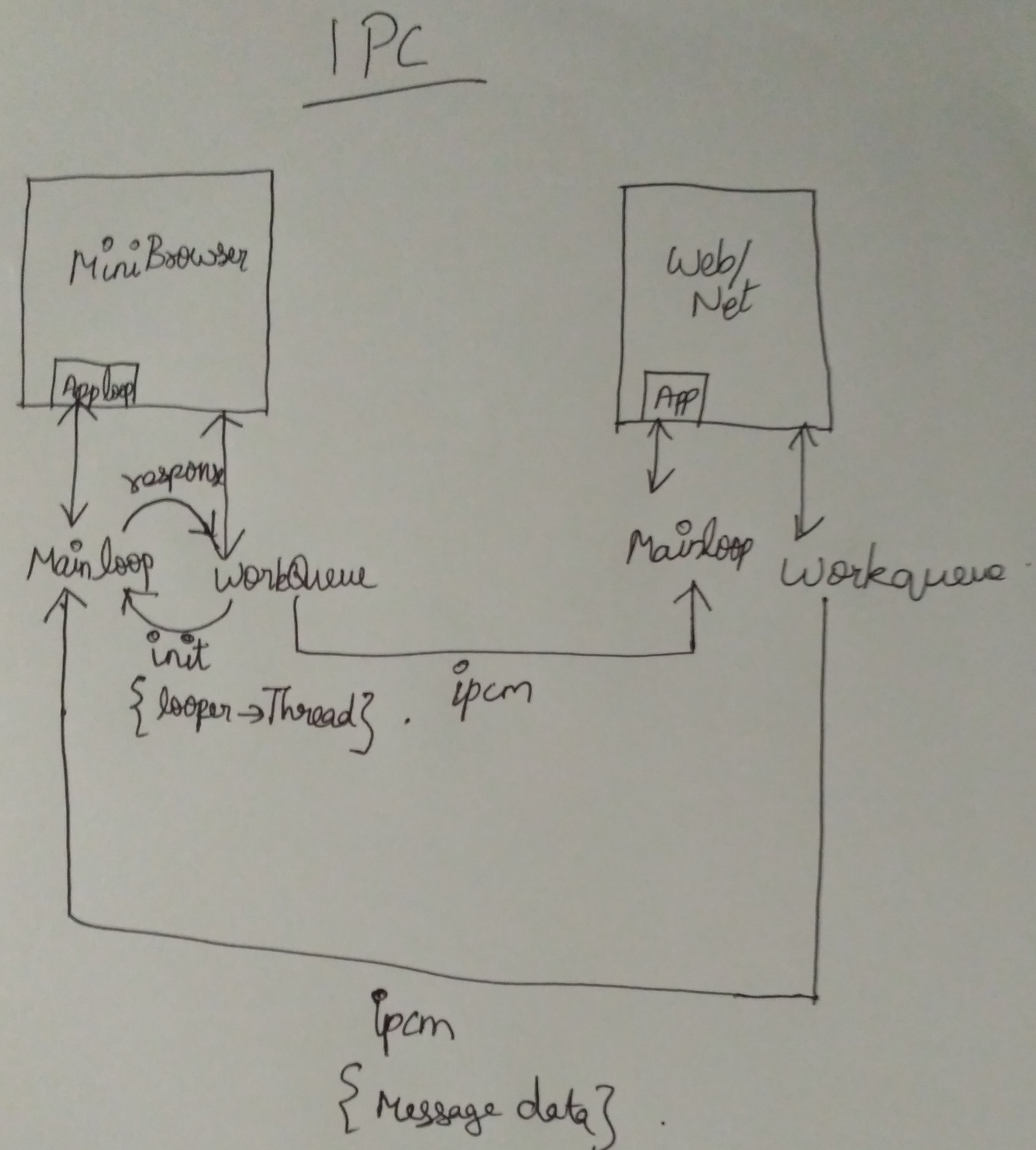

IPC (Inter process Communication)
We wish processes had mouths to speak with other processes instead all they had was BMessage. Other platforms used sockets for the same.
Initially we hit some kind of IPC deadlock as we tried to use mainloop as proxy. So we came to know that if we have BMessenger object then we can send message directly. In this way mainloop had to interfere only once for handshaking. psst It would be nice if we could directly send to any looper in a different process without much work.
https://github.com/RAJAGOPALAN-GANGADHARAN/webkit/commit/641dd71b0f55295d3c8047f22fc8659422a74536
Few fun facts related to IPC:
The initialization is done by first exchanging
'inil'-> sent to application looper (details of particular BLooper where messages from other process is expected)
'inig'->sent to other process( BMessenger object of this looper).
When the other process recieves the bmessenger it forwards to correct looper where message should be recieved. Then once connection is successful each process starts sending messages. Each IPC message is tagged 'ipcm' with Data Attached to them.
And yes I started to give meaningful commit messages. Plus here is one of a kind limited edition doodle by me.

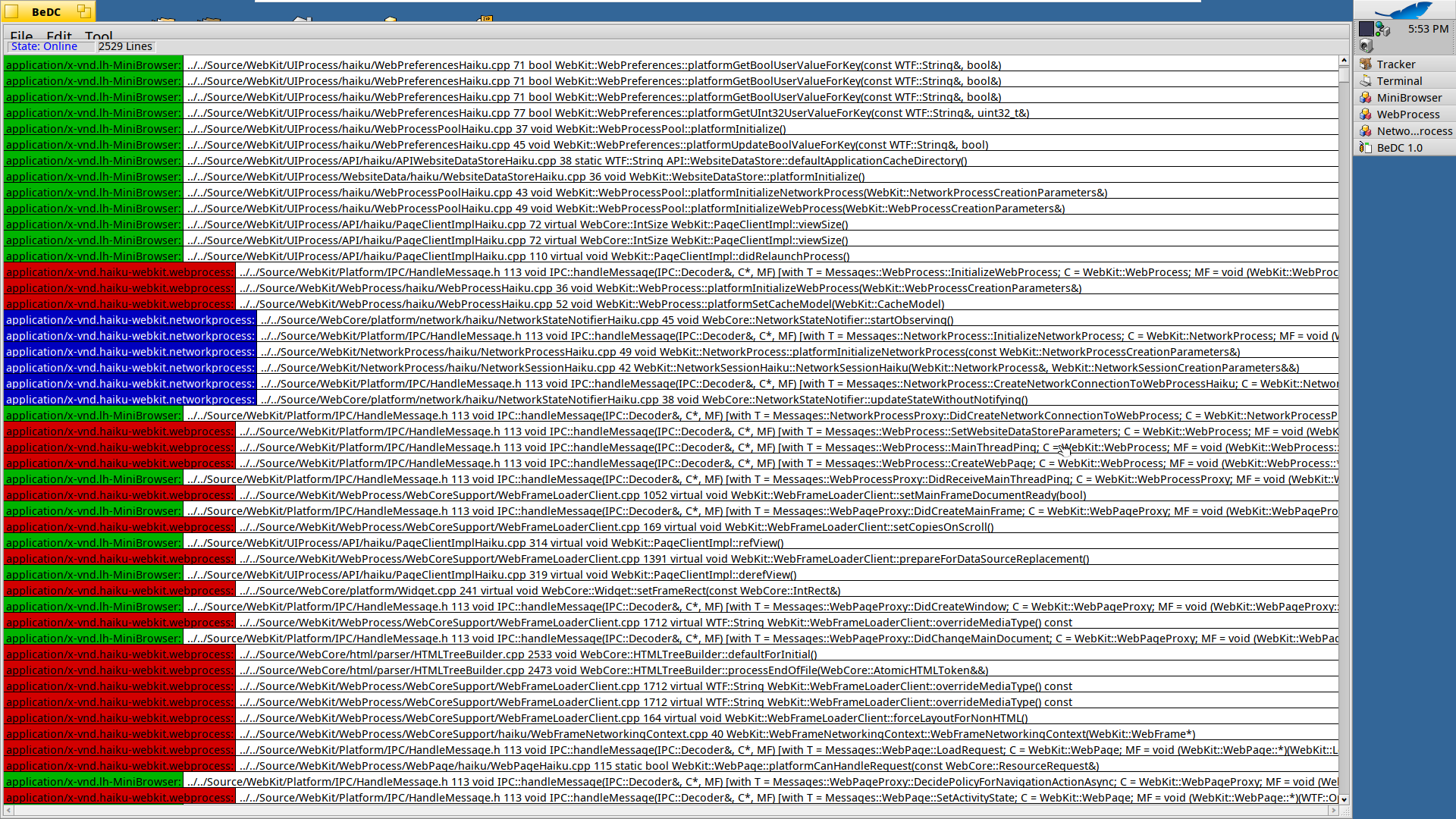

Logging
Have you guys ever tried BeDC its a cool logging tool in haiku (Give it a try!). We couldn’t perform debug build because it always run of memory at that point of time. Maybe it is fixed with the advent of rpmalloc. But we used BeDC to log and to find which part requires tinkering. It is really colorful too.
https://github.com/RAJAGOPALAN-GANGADHARAN/webkit/commit/3b33d1ac69d2f89ea7f660b3fce881148e6ad1a2

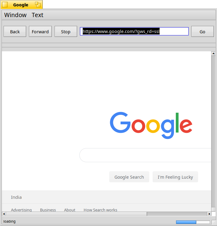

  4. Got webkit to paint webpage!!

List of sites that currently work:
https://www.google.com
http://www.gmail.com
http://bing.com
http://example.org
https://text.npr.org/
