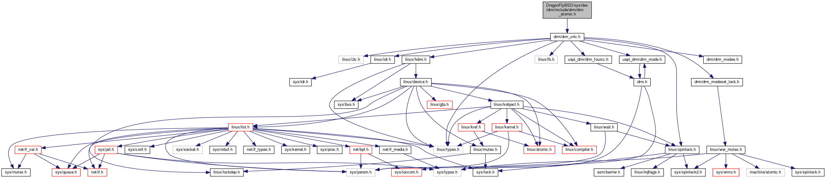

I started off, thinking of trying to generate an include dependency graph (every node in the graph represents a header/source file in the project and every directed edge from file1 to file2 indicates that file1 has included file2). The motivation was if I could generate such a graph, then I could easily move up from the leaf nodes to the highest-connectivity node in the graph, without breaking the compilability of the source. I tried to generate the graph using Doxygen, running it on DragonflyBSD’s sources.
It looked good for some files, like drm_atomic.h shown below.
drm_atomic.h Include Graph
But it failed for drm_auth.c (drmP.h has a fairly large list of dependencies, which I expected to see in the graph, but unfortunately did not).
drm_auth.c Include Graph
I asked people on the mailing list for help, and surely enough, received a lot of it. PulkoMandy suggested some more tools, but none of the seemed to work the way I wanted them to. At last, on PulkoMandy’s and Duggan’s suggestions, I decided to add files to the source and rely on the compiler generated error files to proceed.
