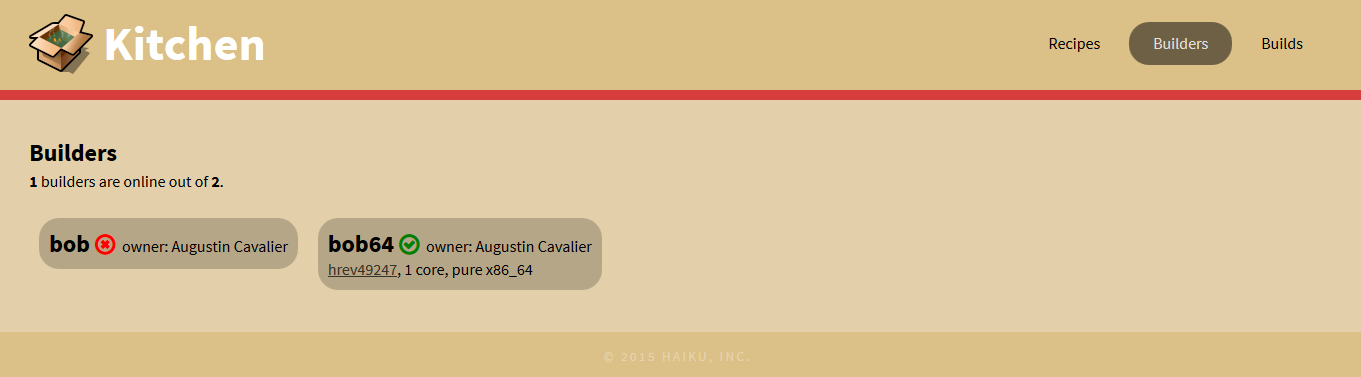

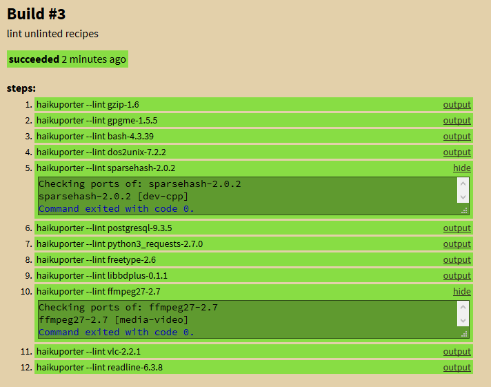

), and then had the core controller use that to create a build that would lint (or re-lint) those recipes. After the usual rounds of bugfixing and refactoring, the system worked, and it properly creates builds and runs those commands on a builder. Those who have been paying attention to the logs of the #haiku IRC channel will have spotted my "mini visual progress reports" containing screenshots of the web interface. For the sake of those who don't use IRC, here they are again:
