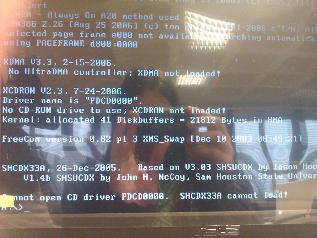

I request your help for my problem.. While running the installation disk, I have an error of XDMA drivers or something like this. I've taken a screenshot to show you my problem.
http://img64.xooimage.com/files/2/b/9/imag0224-24df75c.jpg
I don't know what I have to do to make it work...
Sorry for my bad English, and for more information, my computer is an Asus G73 linked below.

The last line appears to say A:>
This is not Haiku as far as I can tell.

Re: Install Probleme
yes, that is xcdrom not haiku.
hi there
it seems that your cd was burnt with nero that puts a FREEDOS bootloader in the image,i know that option from nero,when you choose "BRUN a BOOTABLE CD",you get this bootloader by default.
you should burn a new cd, but then choose the "BURN IMAGE" option instead,this will get you to boot with the right haiku bootloader and not the FREEDOS one.
