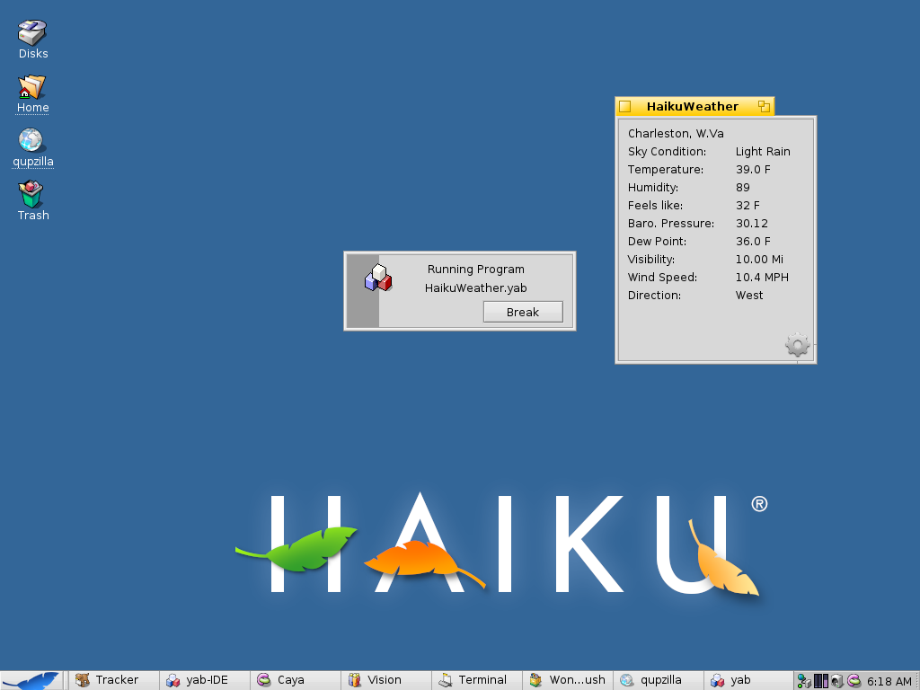

I got a good way into replicating BWeather in yab anyhow, just no idea how to create the deskbar replicant now..

Yab does not have any facility to create replicants, either of the desktop or deskbar variety. You'd have to create a separate little wrapper in C++ that has just one purpose in life, which is to live in the db and call the yab executable when clicked. Come to think of it, if that could be made on a generic basis, so that it could basically load any specified file, it could be a useful utility. Anybody?

Well at least that means I can stop drudging the net for information that does not exist. Yab is starting to feel more and more claustrophobic. I know there is the desklink utility that can create deskbar replicants for any given app, but unsure if it can be used in a way as to update like ProcessController does.
