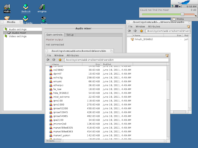

hy..
this my screenshot.
https://lh6.googleusercontent.com/--dRRAglmIR8/Th3gRoxCdPI/AAAAAAAAAW8/H...
i just renamed the folder.
is it a bug?

When you install OpenSound (OSS) you should remove audio driver. There could be conflict between OSS and native Haiku driver. If Via, you have to remove I think auvia.
