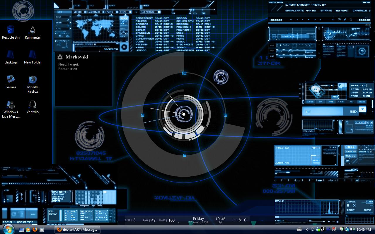

Linux wms are useless, IMHO. Windows shells looks more modern.
For example a SharpEnviro "port" would be great...
...and Emerge looks clean too:
Note: a Reinmeter port would be great too !
Anyway establish some kind of collaboration with these open source projects would be even better than just porting.
