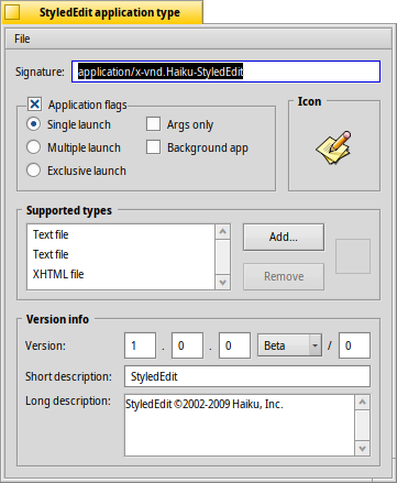

If you invoke the Filetype add-on on an executable (here: StyledEdit), you'll get a different dialog:
On top, you'll see, instead of a standardized MIME string, the unique application signature. With it, the system finds the program wherever it's installed.
Below it are several flags, controlling the app's behaviour:
| Only one instance of the app can be running per executable file. If you have two copies of that app, however, they can run side by side. | ||
| Many instances of the app can run simultaneously. | ||
| Really only one instance with that app's signature is allowed to run at a time. | ||
| Indicates the app doesn't respond to messages. | ||
| The app won't appear in Twitcher or the list of running apps of the Deskbar. |
Then there's the list of supported filetypes. You can add (and remove) filetypes if you think the application can handle them. As a consequence, the app will appear in the menu for preferred applications or Tracker's context menu when you right-click on a file of that type.
At the bottom are version and copyright information. Like the application signature, they are filled in by the app's author and shouldn't be altered.
