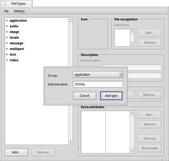

Start the Filetypes preferences, and click on the button below the hierarchical list on the left. A small dialog opens and you specify in which MIME Group your new filetype will reside. You can also create a completely new group. Let's put it into "applications" and set the "Internal name" to DVDdb.
Now, a panel for your new DVDdb filetype opens:

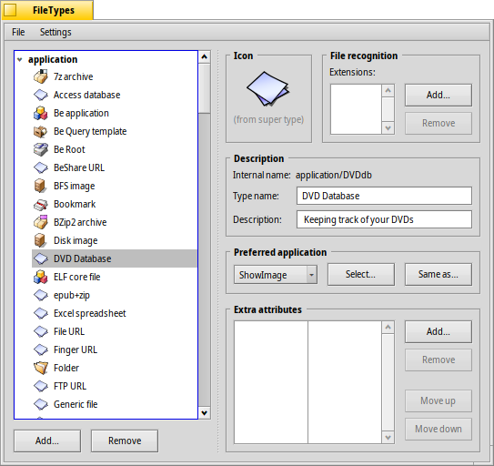

- Type name - Appears e.g. in the"Attribute" menu of Tracker windows and the "Kind" attribute of a file.
- Description - A bit more detailed description.
Preferred application
This pop-up menu shows a list of all applications that can handle this particular filetype. From here you can choose which program should open this specific file when it's double-clicked.
| opens a file dialog where you choose the application to open with this filetype. Here, we set ShowImage to display the DVD's cover. | ||
| opens a file dialog where you choose any file that already has the preferred application set that you're looking for. |

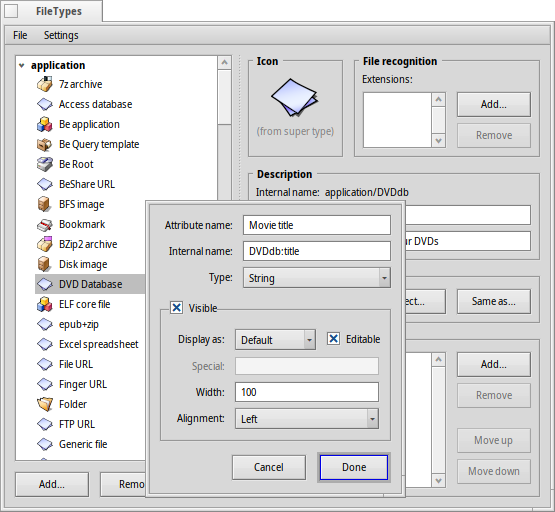

Here we enter all the custom attributes we decided on in our preparations. Clicking the button opens a panel to enter all the data for the new attribute. You can edit an existing attribute with a double-click.
Attribute name - Appears e.g. as the column heading in Tracker windows.
Internal name - Is used for indexing and querying the attribute.
- Type - Defines the value the attribute can hold and therefore how it can be queried.
- for normal text
- for binary data: 0 (false) or >=1 (true)
- for integer numbers with different ranges:
- : -128 to 127
- : -32,768 to 32,767
- : -2,147,483,648 to 2,147,483,647
- : -9,223,372,036,854,775,808 to 9,223,372,036,854,775,807
- for floating-point numbers, single precision
- for floating-point numbers, double precision
- for time and date format
- Visible - This checkbox determines if the attribute is visible in a Tracker window at all. Since the Tracker will be the interface to our DVD database, we check it and define its appearance with:
- - Leave on "Default" if the values are to be displayed according to the attribute's "Type" (e.g. string/integer/float etc.). The other options are:
- - Can be used to show either one of two symbols, see below.
- - Shows an integer as 1/60, e.g. "90" becomes "1:30".
- - Shows a rating between 0 and 10 as star symbols.
- - Determines if the attribute shall be editable in Tracker.
- - Defines the two symbols used for a checkbox display. For example, "xo" will show a "x" for all values >0 and "o" for 0.
- - The default width of that attributes column in a Tracker window.
- - The attribute can be displayed left, center, or right aligned.
Now, insert all the info for our attributes:
| Internal Name | Attribute type | indexed? | Description |
| DVDdb:title | text | yes | Movie title |
| DVDdb:genre | text | yes | Genre |
| DVDdb:url | text | no | URL |
| DVDdb:cast | text | yes | Director/Cast |
| DVDdb:plot | text | no | Plot |
| DVDdb:rating | int-32 | yes | Rating 1 to 10 |
| DVDdb:coord | text | no | Shelf |
| DVDdb:lent | text | yes | Lent to |

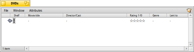

Now, we activate all our DVDdb attributes from the menu of the Tracker window and rearrange the columns to our taste:
By clicking on a yet empty attribute (or pressing ALT E) we enter editing mode and fill each attribute. With TAB and SHIFT TAB you can navigate between attributes.
In our example, we usually start with a downloaded JPG cover and change its type to applications/DVDdb. There's another elegant way to produce a file to work with. Just copy an empty file of our filetype to /boot/home/config/settings/Tracker/Tracker New Templates and rename it to DVDdb.
Right-clicking into a Tracker window, you'll find a new entry under besides the default "New folder".

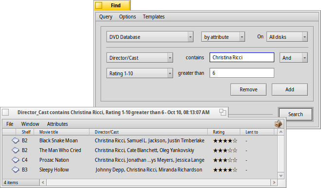

Several hours of grunt work later, we have a nice little database that you can query to find all your Christina Ricci movies that have a 7 rating… :)
You can assign a sensible attribute layout for query results of a specific filetype.
Open the folder containing your DVDdb files and arrange the attributes how you'd like to have query results presented. Copy this layout with .
Open /boot/home/config/settings/Tracker/DefaultQueryTemplates, create a new folder and rename it to group/filetype, replacing slashes with underscores; in our case "application_DVDdb".
Open the new folder and paste in the layout with . Voilà:
