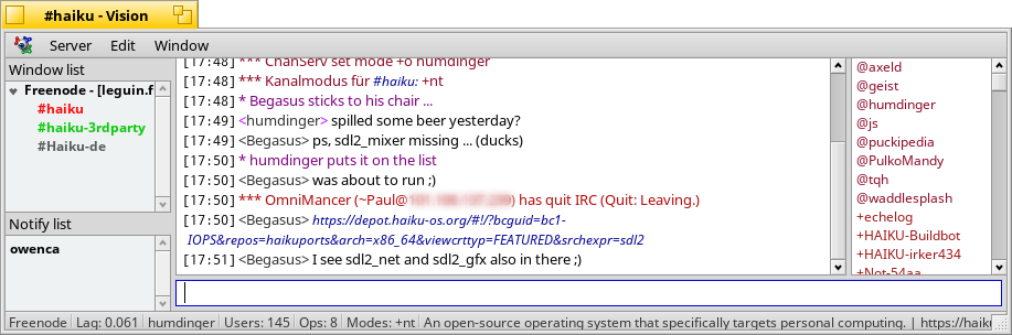

Vision jest klientem IRC oryginalnie napisanym dla BeOS-a. Dokumentacja i bug tracker są dostępne na stronie Vision.
The most frequented channel is the English speaking #haiku at irc.oftc.net.
Kilka porad, w szczególności jeśli nie wiesz co to IRC:
Search the web for "IRC etiquette" to learn about the do's and don'ts of chatting. Without much searching, I found Getting help on IRC by Christoph Haas to be quite helpful.
By registering your nickname you make sure nobody can pull any shenanigans and you gain the trust of the residents. See OFTC's FAQ on that matter.
Set up a sound in Haiku's Sounds preferences to be notified if someone mentions your nickname. People don't always watch their IRC client screen. Putting the nickname of the person you're talking to at the beginning of what you're about to post increases your chance to be noticed. Similar to the Terminal, Vision supports tab-completion for nicknames, i.e. if you enter the starting letters of a nickname and press the tab key, Vision completes it with the first name that matches.
