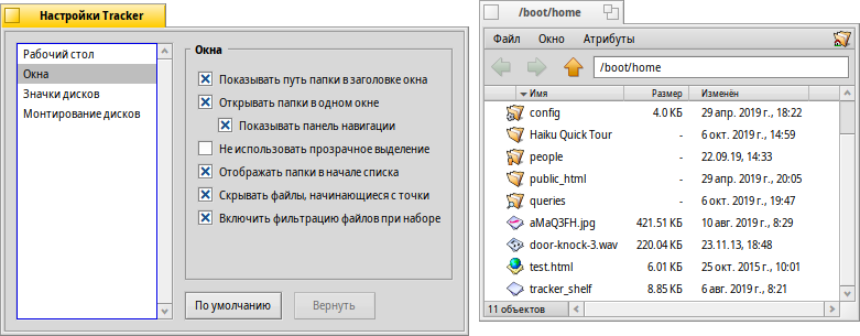

Меню открывает окно, которое предлагает ряд настроек. Все настройки применяются в реальном времени, таким образом все изменения будут сразу же видны.
Перейдем к описанию настроек:
- Предлагает отобразить все разделы непосредственно на рабочем столе либо в окне после нажатия на иконку диска на рабочем столе.
- You can set , i.e. a double-clicked folder doesn't open in its own window, but inside the already open window instead, replacing the view of its parent folder. This is not the same as clicking while holding the OPT key, as described above, because you'll lose the per window saved position and size.
Before you switch Tracker to , because that may feel more familiar to you, we recommend giving the menu based browsing a try first, as that may actually work much faster for you after getting used to. On the other hand, single window browsing offers a Navigator where you can enter or copy & paste a path name and use back, forward and up buttons.
Activating will filter the contents of a Tracker window while you type to only display the files matching your string in their name or any currently displayed attribute. See above.
and you won't see files starting with a ".", a popular naming convention for configuration files under Linux.
You can which will replace the standard icons for image files.

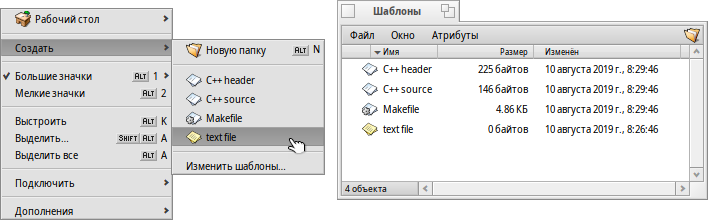

- Create a new folder or any other file based on a template.
Choosing at the bottom opens the folder /boot/home/config/settings/Tracker/Tracker New Templates. Create a file or folder there and it will appear as a template in the menu. The new file/folder created by the template will have its filetype, filename, contents, and all its other attributes. In case of a folder, it'll also have its window size/position and attribute column layout.
In the screenshot above, you see the custom template folders "Email folder" and "Music folder". Both will create folders with those same custom overlay icons and have the relevant attributes already set.
You can also sort your templates into custom submenus. Just choose and a new special folder gets created in Tracker New Templates that you then rename to fit its purpose. Copy your template files there to appear in the new submenu. The screenshot above shows the submenus "C dev files" and "Office files".

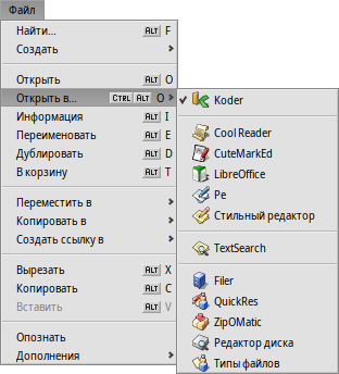

- Подменю предлагает все приложения, с помощью которых можно открыть этот тип файла.

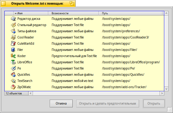

Галочкой отмечено предпочтительное приложение, в котором будет открыт файл при двойном щелчке. В этом подменю на первых позициях расположены приложения, которые точно могут обрабатывать этот тип файлов - в нашем случае это текстовый файл типа text/plain. Далее идут все приложения, которые могут обрабатывать этот супертип, в нашем случае - text/*. Последние приложения в списке - это приложения, которые могут открыть любой файл. Если вы не станете выбирать приложения из списка, а щелкнете по пункту меню , то откроется следующий диалог:
Здесь вы найдете те же приложения, которые были предложены в подменю. Выбрав одно из них и нажав кнопку , вы измените предпочтительное приложение для данного типа файлов, в нашем случае для text/plain.
