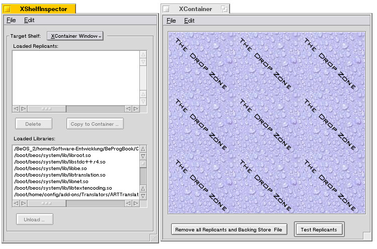

First, launch the XShelfInspector application. XContainer will then be launched, too.
Figure 1: XShelfInspector and XContainer
Now drop your freshly built replicant to the "Drop Zone." let's use the well-known RepliShow replicant. If XContainer's container view accepts the replicant, fine, the first step is done. Next step: Try to drag the replicant around using the small dragger, then release the mouse button, and if the replicant is still there, fine again. Then check the functionality of the dragger's pop-up menu. Then comes the most crucial part of testing: Push the "Test Replicants" button. The XContainer application will be terminated and all replicants be saved to an archive. XShelfInspector will restart XContainer immediately, and hopefully your replicant will be rebuilt properly. Alternatively, you can close XShelfInspector and launch it again - you should see the same behavior. How can we get rid of the replicant? One way is to use the above-mentioned pop-up menu and to select "Delete". Repeat the "Test Replicant" procedure - no replicant should be reconstructed any more. When you drop your replicant to the "Drop Zone" again, it should reappear.

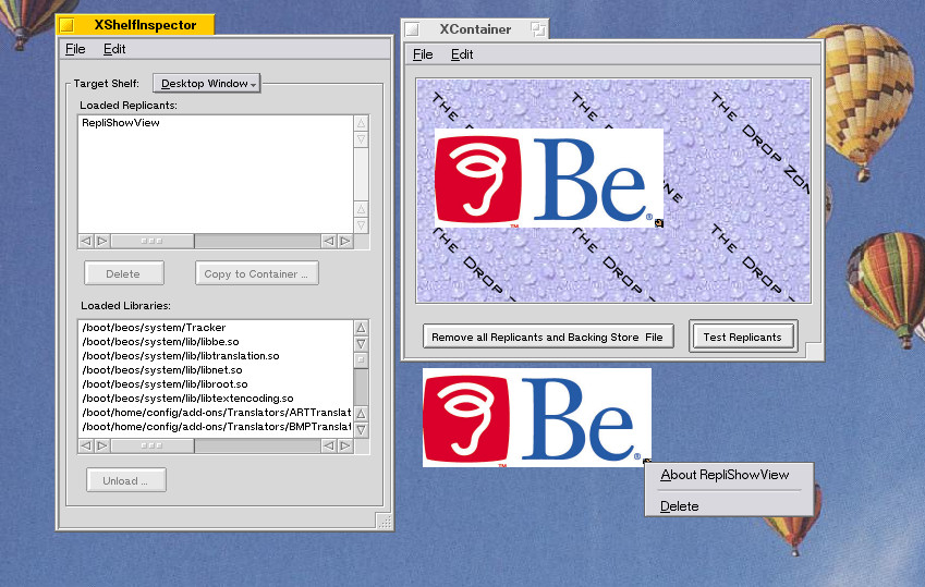

What other things can we do now? Since your replicant is looking sane we can dare to drop it onto the Desktop window.
Figure 2: Replicant Pop-Up Menu

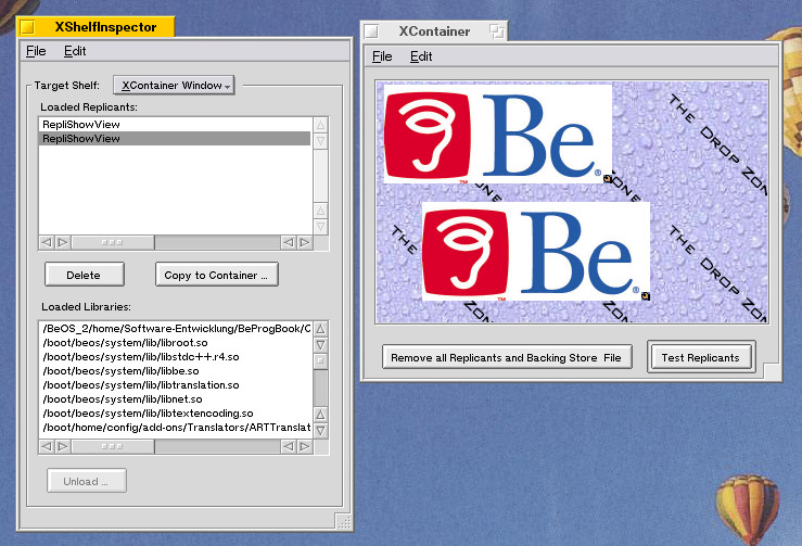

After doing this select "Desktop Window" from XShelfinspector's "Target Shelf" pop-up menu and you'll see the loaded replicants and the loaded libraries. (This is not working when you use Be's original ShelfInspector application!) Another thing you can do is to clone the replicant. Select the desired replicant in the "Loaded Replicants" scrollview and press the "Copy to Container ..." button.
Figure 3: Copy to Container

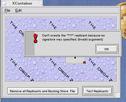

Figure 4: The line AddString("add_on", "application/x-vnd.BeNews-RepliShow") is missing inside the Archive() function.

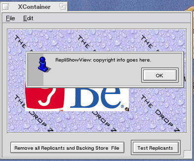

Figure 6: You have forgotten to add your own "About Requested" function.

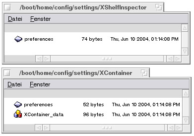

A final word about XShelfInspector and XContainer: When closing these applications the window size and position is saved in a separate settings file.
Figure 7: Settings.
Here you see the settings of both apps, and XContainer is also keeping the backing store file XContainer_data. If your replicant is so corrupt that XContainer will not launch without crashing, you only need to delete this file.
