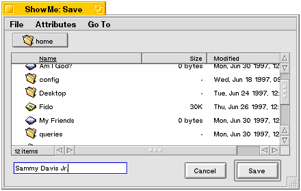

BFilePanel knows how to create and display an "Open File" or "Save File"
panel, and provides the means for filtering and responding to the user's
actions on the panel. The Save Panel looks like this:
The Open Panel looks pretty much the same, but without the text view in the lower left corner.

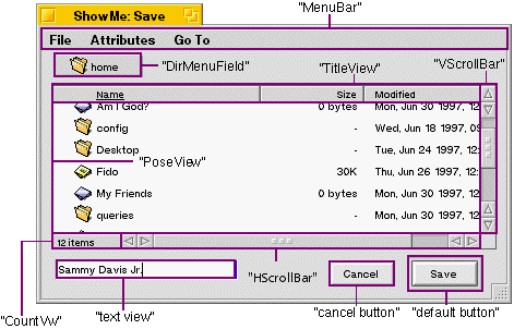

There are two ways you can modify the look of your
BFilePanel object.
You can do some simple text twiddling by calling the label- and text-setting functions SetButtonLabel() and SetSaveText().
If you need to really change the look, you can get a handle on the panel's BWindow and BView objects in order to move them around, add your own, or whatever. You get the window through the Window() function. Finding specific views within the window is described below.
The views in the panel are (mostly) named, as listed and shown below
"MenuBar" is the window's menu bar.
"DirMenuField" is the path popup.
"TitleView" is the bar that holds the attribute titles.
"PoseView" is the scrollable list of files.
"VScrollBar" and "HScrollBar" are the vertical and horizontal scroll bars.
"CountVw" is the item counter to the left of the horizontal scroll bar.
"text view" is where the user types a file name (Save Panel only).
"default button" is the Save or Open button.
"cancel button" is the Cancel button.
The background view doesn't have a name, but it's always the first in the window's list of views:
BView*background=filepanel->Window()->ChildAt(0);
The other views can be found by name, reckoning off of the background view. For example, here we get the "PoseView" view (the view that contains the file list):
BView*files=background->FindView("PoseView");
