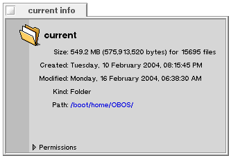

If you are obtaining the entire source for the first time, please be advised that this can take some time depending on the speed of your internet connection, etc. The entire source, some 2,000,000-plus lines of code, will take up about 300-600 MB of your hard drive.

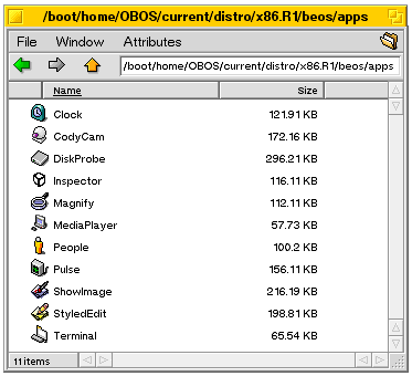

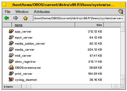

For those that want to play with some of the components of OBOS, go back to your Terminal window and change directory (cd ) to distro.
Below is a screenshot of some of the goodies you will find:
