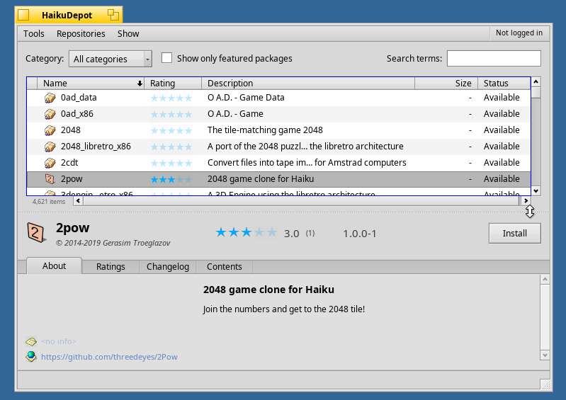

A container with two or more sections, with dividers in between, so that a user can manipulate the size of the sections by dragging a slider. More...
This container view consists one of more items, that are laid out horizontally or vertically. Between two adjoining items, there is a splitter. This splitter allows the user to change how the space between the individual items is divided.
The screenshot below shows the BSplitView being used in HaikuDepot. The BSplitView is the main container of the window, in this case with a B_VERTICAL layout. The top part contains the list of packages, and some filter tools. At the bottom are individual package details. In between the two visual elements there is a dotted line, indicating the draggable separator. At the right hand of this separator, above the Install button, you can see that the mouse cursor changed into the double arrow, indicating the user that the element is dragable.
Because of the dynamic nature of the size of the sections within the split view, it is best to use this container with the layout system. It is fully supported by the layout builder utilities. See the BLayoutBuilder::Split<> documentation for the builder that accompanies this view.
The container has the following properties:
Specifically for individual elements, the following properties may also be set:
BGroupView essentially has the same properties for organizing the layout items, though it does not offer the functionality for users to change the size of the elements.
Since
Haiku R1
