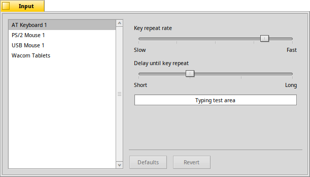

Keyboard
Set the repeat rate, and the delay until a held down key starts to repeat. You can test your settings in the text field at the bottom.
| resets everything to default values. | ||
| brings back the settings that were active when you started the Keyboard preferences. |

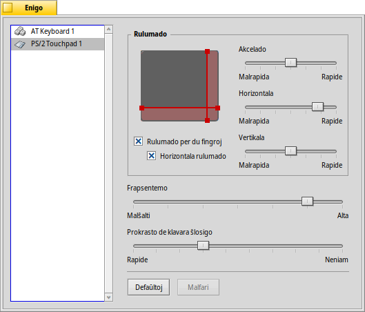

Touchpad
By dragging the red vertical or horizontal lines on the touchpad representation, you set the scroll area (slightly reddish against the gray general touch area). Moving your finger on that part of the pad will move the scrollbars of a window accordingly.
To the right are sliders to set the general scroll acceleration and the vertical and horizontal scrolling speed.
The acceleration setting decides how much quicker a list scrolls by if you swish over the scroll area very fast. The scrolling speeds control the general speed when using the scroll area in a "normal" way.
Below the touchpad graphic are checkboxes to enable for vertical and horizontal scrolling. Move two fingers in parallel vertically or horizontally to move the scrollbars of a window.
If you feel comfortable using this feature, you can dispense with setting scroll areas and instead use the whole pad for normal navigation.
Then comes another slider to set the . If your taps keep getting ignored, increase the sensitivity. If the system registers clicks all the time, while all you want is to move the mouse pointer, try decreasing it.
Finally, you can set a . If you accidentally tab your touchpad while typing and thereby move the text insert cursor, try to decrease the lock delay.
| brings back the settings that were active when you started the Touchpad preferences. |
