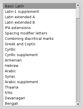

Displays a list of items that the user can select and invoke. More...
BListView's can be one of two types set by the type parameter of the constructor:
B_SINGLE_SELECTION_LIST Can select only one item in the list at a time. This is the default.B_MULTIPLE_SELECTION_LIST Can select any number of items by holding down Option for a discontinuous selection, or Shift for a contiguous selection.An example of a BListView looks like this:
Click on an item to select it and double-click an item to invoke it. The BListView doesn't define what it means to "invoke" an item. See BListView::SetSelectionMessage() and BListView::SetInvocationMessage() to set a message to be set when these actions occur. You can also select and invoke items with keyboard keys such as the up and down arrow keys, Page Up and Page Down and the Enter key or Space key to invoke the item.
This class is based on the BList class from the Support Kit and many of the methods it uses behave similarly.
Although a BListView is scrollable, it doesn't provide scroll bars by itself. You should add the BListView as a child of a BScrollView to make it scrollable.
The code to add a BListView to a BScrollView looks something like this:
