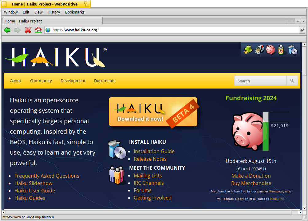

First, some background. Haiku’s native browser is WebPositive.
Screenshot of WebPositive
WebPositive’s code mostly deals with the user interface. It uses our fork of WebKit, HaikuWebKit, to actually render the web pages, run JavaScript, process input, and so on. WebKit (and, by extension, HaikuWebKit) provides two API versions: WebKitLegacy, and WebKit (aka WebKit2). Unfortunately, we are still stuck using WebKitLegacy even though WebKit2 has been out for more than a decade.

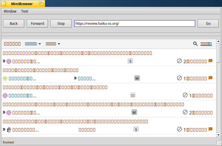

Success! Now MiniBrowser displays things once again. Here is MiniBrowser showing https://review.haiku-os.org/
MiniBrowser showing review.haiku-os.org. All the text’s characters are rendered as squares with black borders.
So, yeah, there’s still plenty of work left to do. Text isn’t rendered properly, keyboard and mouse support is missing, the window can’t be resized without MiniBrowser crashing, and it crashes when exited. I’ll take it one step at a time. Let’s make the mouse work! Then I can actually click on stuff. I think implementing that will be straightforward.

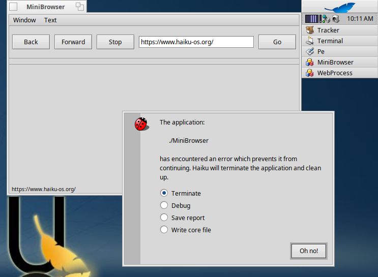

MiniBrowser crashed after attempting to visit a website. Only MiniBrowser and WebProcess show up in the Deskbar.
Currently, MiniBrowser (the simple browser that we use to test WebKit2) crashes rather easily. It crashes when it is closed, but that’s not too bad. Unfortunately, it also crashes when trying to navigate to a website (shown above)! I will be working on fixing this crash first.
