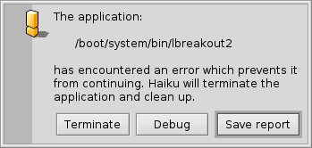

调试器是一般用户不太会用得到的工具。它一般供开发者使用,来检查软件程序中的错误。有时,这些错误会导致软件崩溃,这时候,就算是一般用户也有可能接触到调试器。当一个程序崩溃了,会弹出这样一个对话框:
对于崩溃的程序,可以采取四个动作:

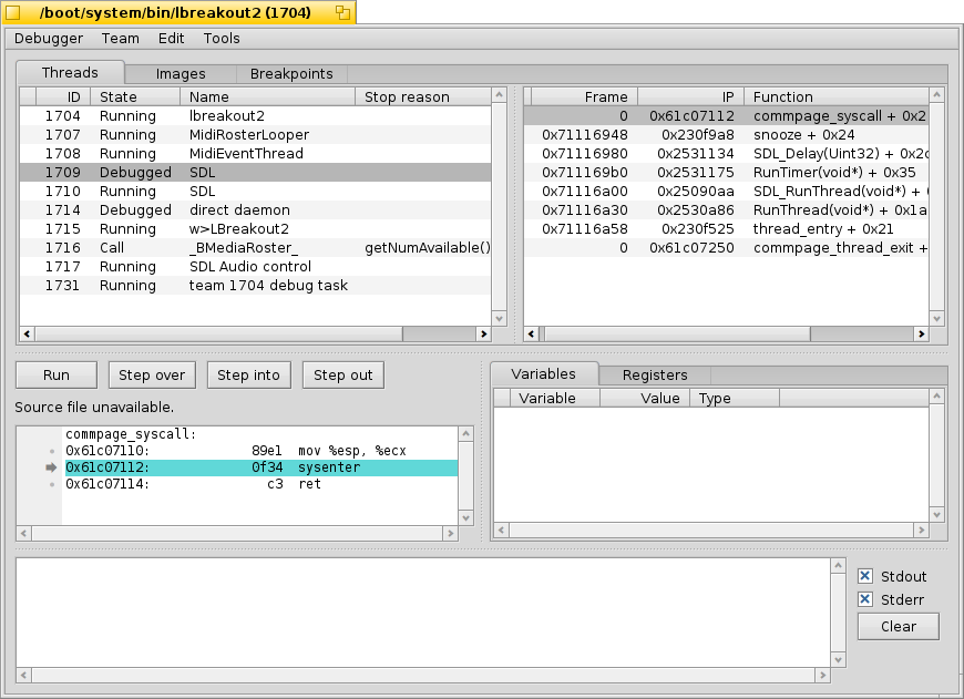

Describing the usage of the actual Debugger is out of scope for this guide that is addressing the needs of the common user of Haiku. For completeness sake, here's the window that'll come up if you choose the Debug option in the above alert:
As you'll quickly see when you start poking around a bit, the Debugger is one of the most complex and sophisticated applications for Haiku. If you're a developer and are used to graphical debuggers on other platforms, many features will be familiar to you.
