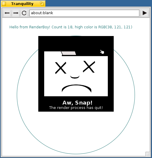

Haiku Native Browser Prototype (aka Tranquility): Our prototype: a simple toolbar and a bitmapHaiku Browser Prototype (aka Tranquility)
As you can see the icons are far from beautiful but they are temporary. (Any constributions or ideas from a graphic artist are welcome.) As we liked the menu bar background in Haiku, we used the same for the toolbar.
Since Ryan made the basic structure of the browser (renderer/browser), I designed the multiple rendering processes support, so that I can decently understand how our prototype works. I had fun designing a sad tab à la Chrome. When a RenderBoy (that’s the name of our rendering engine) quits, the browser (or browser tab when tab management will be complete) displays a ‘sad tab’ bitmap.
Tranquility - Sad TabTranquility - Sad Tab
