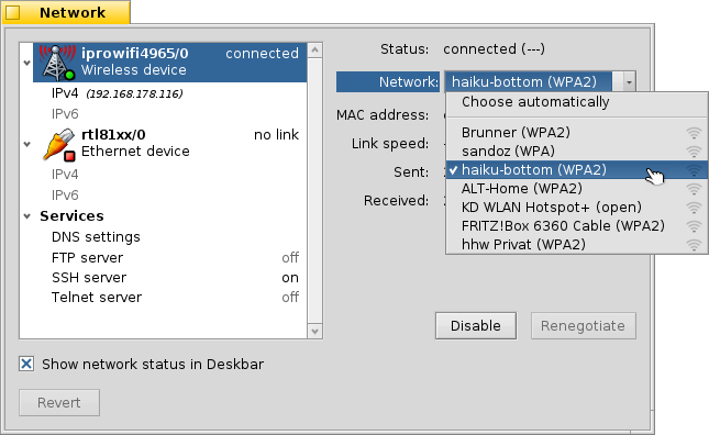

Here we see the wireless device, using the iprowifi4965 driver. From the pop-up menu you select the WLAN to connect to. After every WLAN name in the menu, you're shown a little icon representing the signal strength.
Once a WLAN is selected, Haiku will try to connect to it automatically on every bootup. Select and it'll try to connect to the WLAN with the best signal around.
If you're connecting to a protected network, you'll be asked for the password and if to either allow that connection only once, or always, which will save the password so you won't be bothered to enter it in the future.
The buttons below let you the device, or the connection.

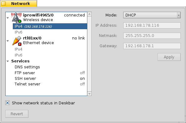

Beneath a device you find a list of the available protocols, IPv4 and IPv6:
From the pop-up menu you set the mode to assign the vital network parameters , and . You can choose to dynamically get the configuration from your network (router etc.), or specify them yourself by selecting and pressing when finished.

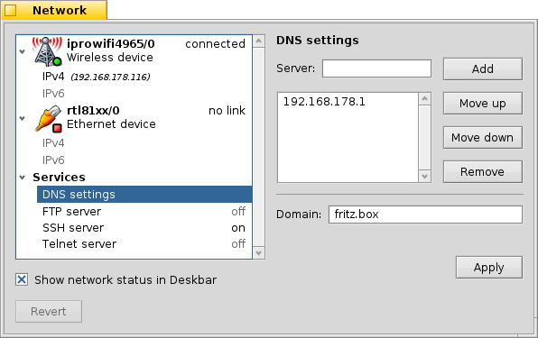

Impostazioni DNS
If you're using DHCP the IP address for a DNS server and the domain are provided by you network (router etc.). You can add and remove other DNS servers and adjust their priorities by moving them up and down in the list with the buttons to the right of it.
will activate your new settings.

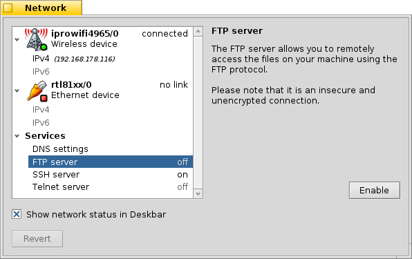

FTP, SSH, Telnet
Haiku provides a few servers that you can or . On the right side of the window, you'll find information on that particular server that you should heed: The FTP and the Telnet server are insecure and unencrypted. By default they're turned off and should only be turned on, if you're aware of the security risks.
