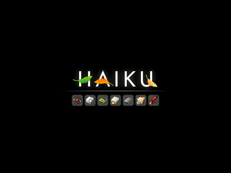

Insert the Haiku Installer CD into your CD-ROM drive and power up your system. After a few seconds, you should see the following Haiku boot splash screen.

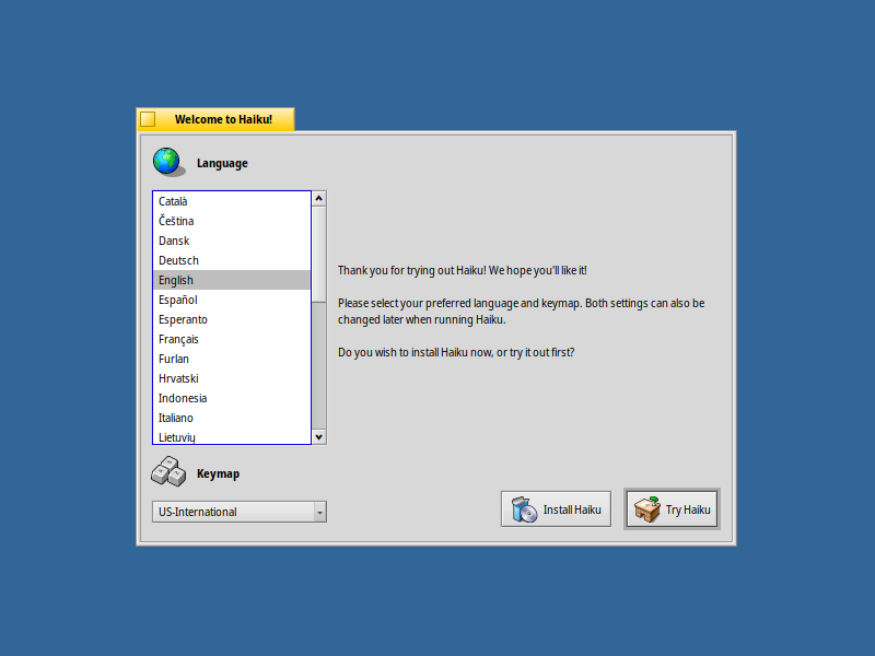

The following panel (depending on your hardware it can take a while to appear) lets you set the system language and keymap.
Then you have to decide to either install Haiku on a partition by clicking or try out Haiku by booting to the desktop directly from CD by choosing .

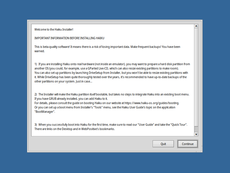

Before the Haiku Installer starts, the following notice is displayed. It contains some information regarding prior partition setup as above and GRUB setup as further below in this guide. Click on the button to proceed to the Installer.

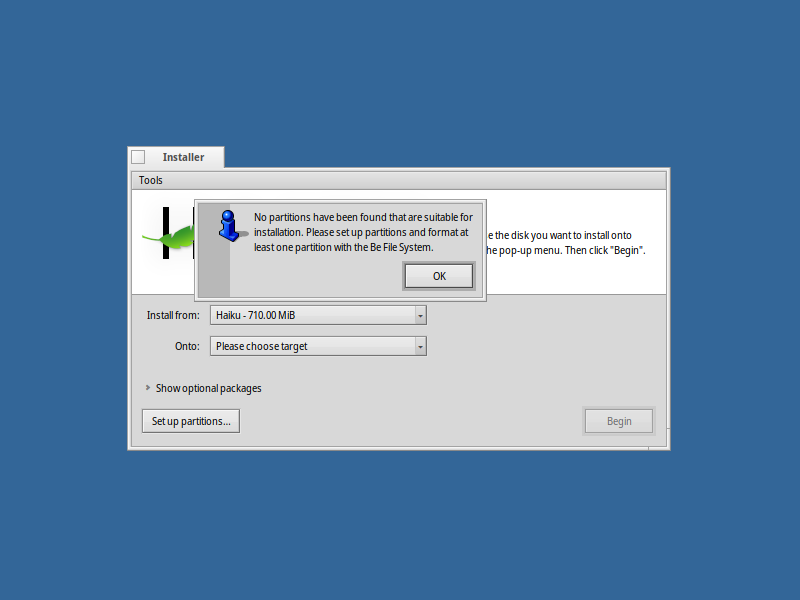

If the following alert pops up, this means that no partitions with the Be File System (BFS) have been found. Click on . Note that if there are already BFS partitions on your system, this alert will not be shown.

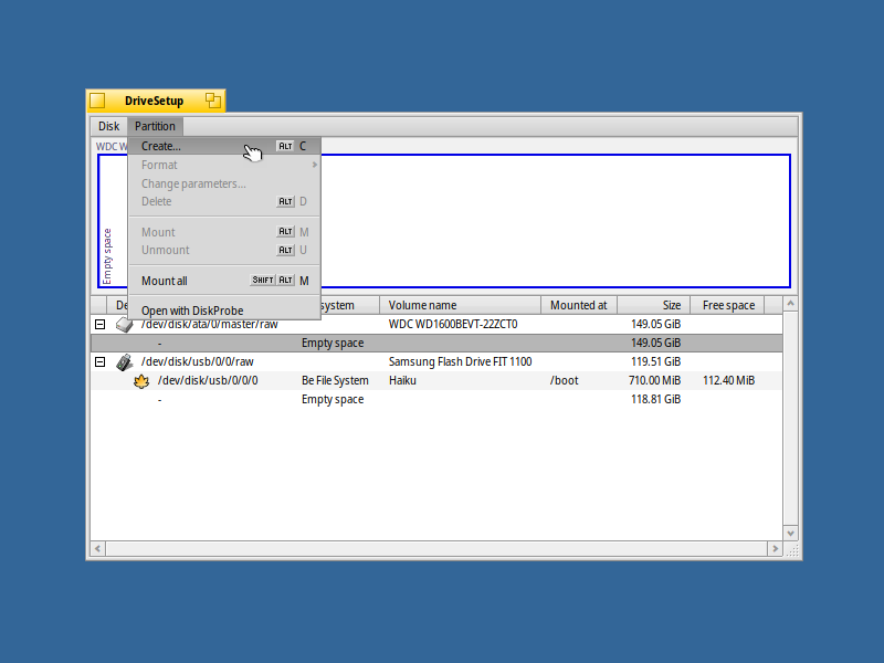

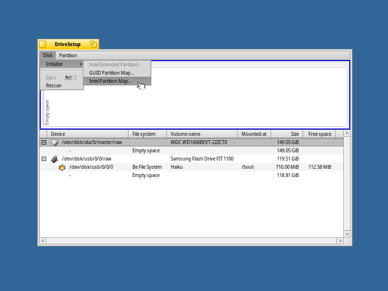

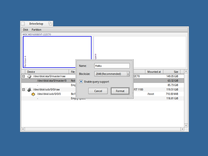

When you don't have a BFS partition available where Haiku can be installed to, or if you want to use a different partition, you will need to use the DriveSetup partitioning application. To start DriveSetup, click on the button.

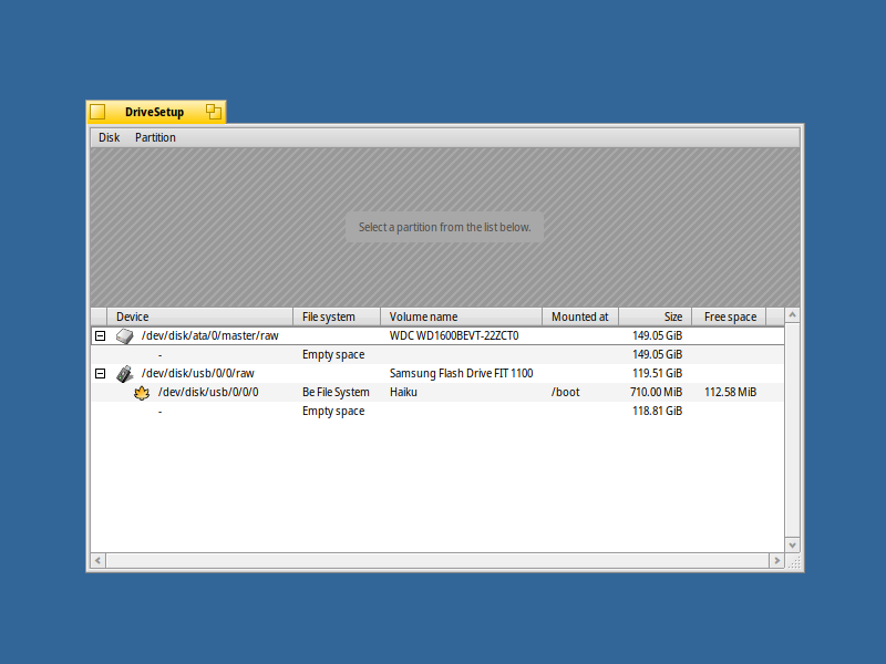

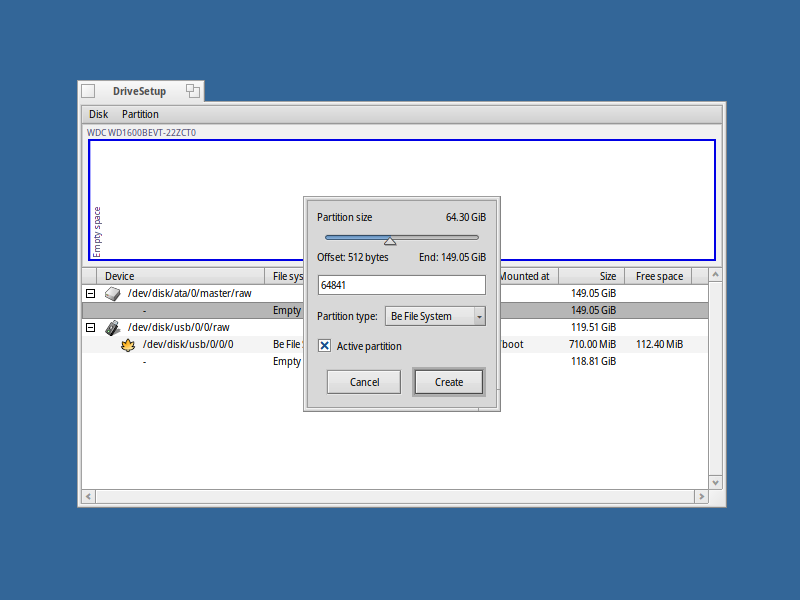

The Haiku partition manager DriveSetup appears and shows the disks and partitions that have been identified. An example setup is shown below.
In this example you can see that there already are two primary partitions. One of about 9GB using an Ext File System, and another one of 2GB with a FAT32 File System. There are also two extended partitions that are still empty. These partitions have been previously prepared using a partitioning tool. Now choose the partition you want to install Haiku on by selecting it from the list. As soon as you select a disk, the partition layout will also be graphically represented. You can then also choose the partition by clicking on it in the layout graphic. The currently selected partition is marked by a blue border in the layout graphic and by a darker gray color in the list.

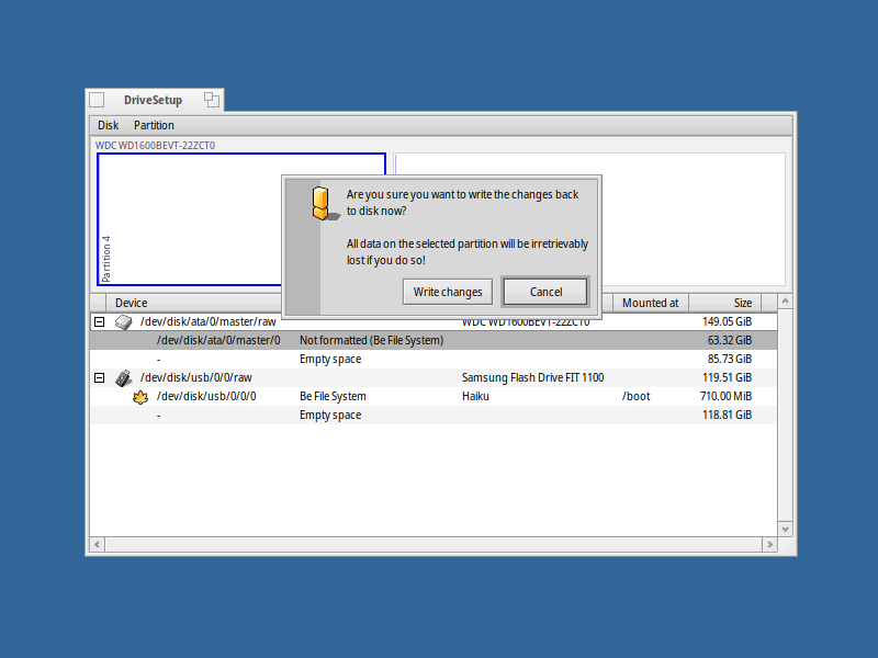

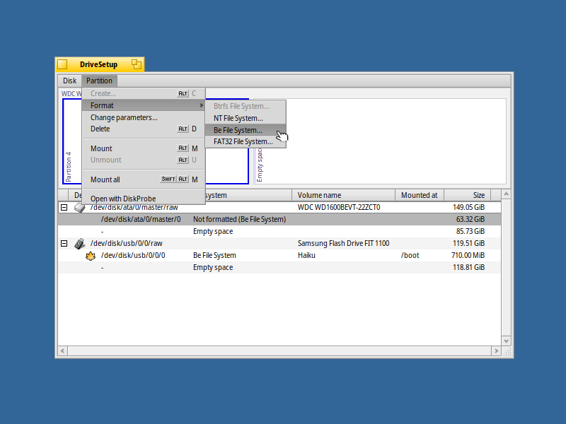

To initialize a partition to the Be File System, make sure the right partition is selected, then use the menu Partition -> Format and click on Be File System....

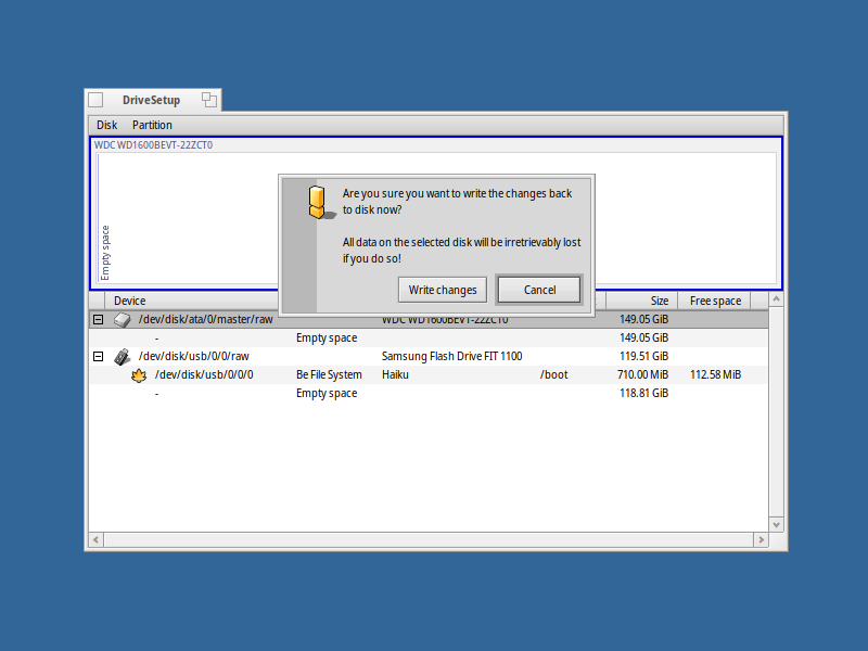

A prompt will come up that asks you if the initialization should be started. If you are still sure you have the right partition selected, click on the button; otherwise, quit the initialization by clicking on . As the alert says, you can still abort initialization before writing any changes to disk.
The next step is used to enter a name for the new partition that you are about to initialize. Enter the name you would like your new partition to have, or simply leave the suggested "Haiku". Here you can also select a blocksize if you want; the default blocksize of 2048 should be fine for most uses, so you can leave this as is. Afterwards, click on to continue.
If everything still looks fine, click on ; otherwise, quit using the button.

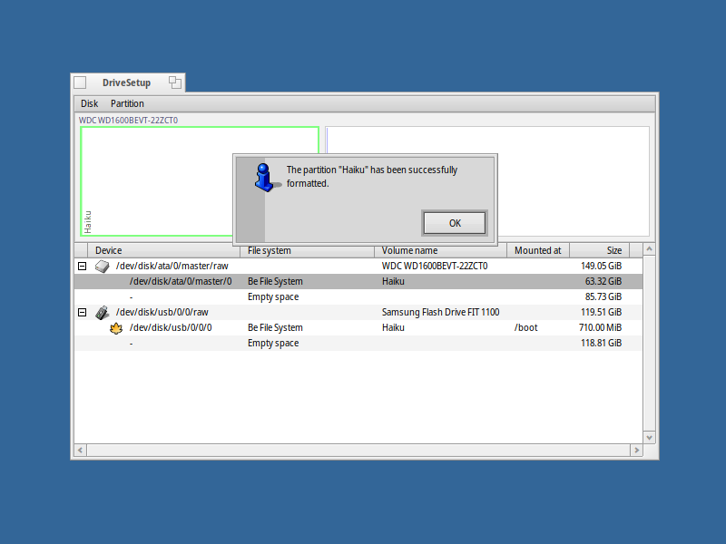

The partition has been initialized with the Be File System. Click on to close this notification.
You can now see the file system type and name has been updated in the list. Also, the graphical representation should now bear the correct name. The partition setup is now complete. Exit DriveSetup by clicking on the left upper corner of the tab or use ALT W.

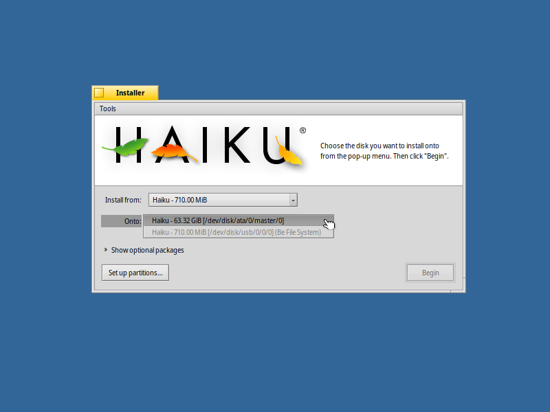

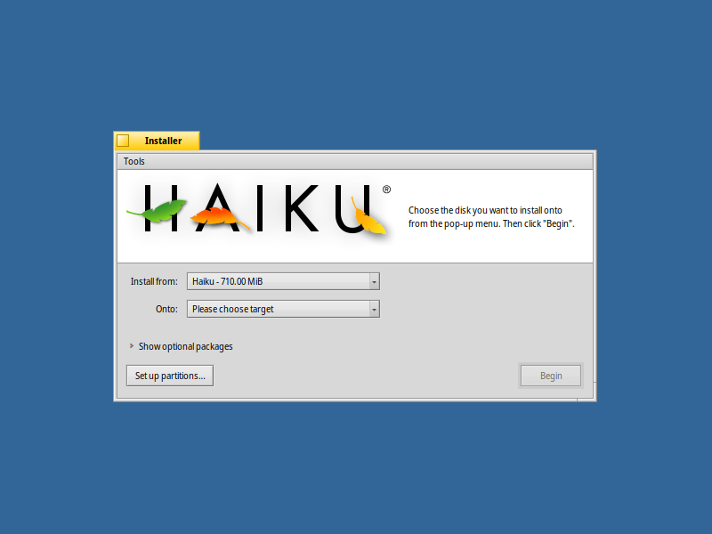

The Installer will become visible again and should now show an updated list of target partitions under Onto like in the following screen. You can now choose your freshly initialized partition (or a pre-existing one if you already had one) as the installation target.
The volume with the name Haiku has been chosen as the target for installation and we are now ready to begin. Click on to start the installation.

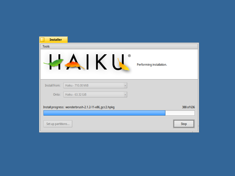

Soon after that, files start to be copied and a progress bar with a file count is displayed as seen in the screenshot below.
While the copying is taking place, it is always possible to quit the process by clicking on the button.

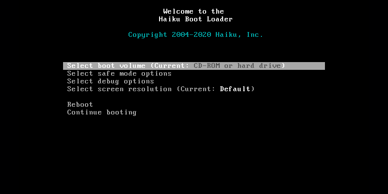

Boot using the CD
You can also use the boot CD to boot into your Haiku installation without adding it to a boot manager. To do so, press SHIFT before the CD begins to load. This will bring up the boot loader menu as seen in the following screenshot.

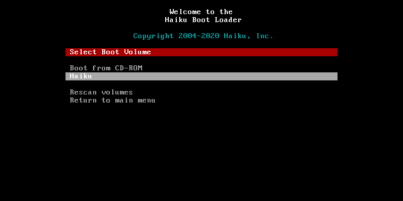

To choose the installation to boot from, press Enter to navigate to the boot volume selection. Your installation should now be listed.

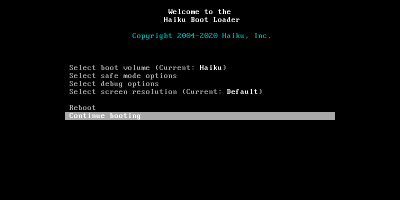

Select the volume using the arrow keys and press Enter again to choose it as the boot volume. You will be returned to the main boot loader menu which now shows your choice as shown below.
The selection will automatically jump to Continue booting. Press Enter again to start booting into your Haiku installation.

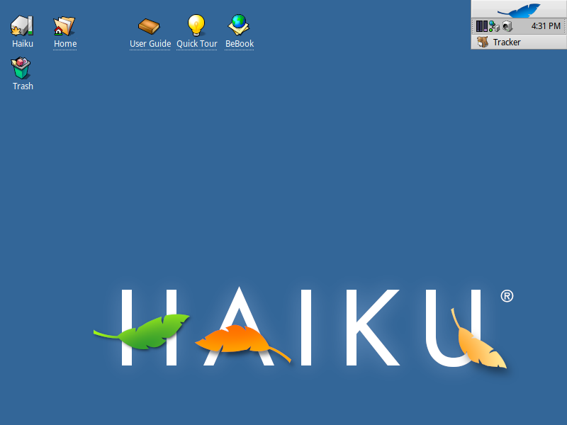

First Boot
Once fully booted, you should be greeted by a screen like the one shown below.
Some background processing will still take place the first time you boot Haiku, so don't be alarmed by the disk activity. After a little while, the system should settle down. Make sure to read our Welcome documentation; there is a link on the Desktop.
