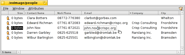

The file itself doesn't even need any contents at all. Take a look at these People files for example:
As you can see, these are all 0-sized files with attached attributes, the E-mail attribute of "John Nox" being edited right in Tracker.

Attributes are displayed quite similar to a database or spreadsheet. Using Tracker you can choose which attributes to display (columns) and sort file listings (rows) accordingly.
To do this, open a Tracker window, click on the menu, and select the attributes you want to display. Alternatively, simply right-click onto a column heading and mark the items in the context menu. You can rearrange the columns by a simple drag&drop of the column heading. Moving a column out of a window, is a fast way to get rid of columns you don't need.
Double-click on the line between two attributes in the heading to automatically resize a column to its optimal width.
Click on a column heading to toggle the sorting order from ascending to descending. You can establish a secondary sort order by pressing the SHIFT key while clicking on a column heading. You can sort your People files by company and within that order sort by contact name, for instance. See the above screenshot as an example. The secondary sort order is marked by a lighter colored indicator beside the heading.
Editing these attributes is as simple as renaming a file: Either click on an entry or press ALT E and move between the attributes with TAB and SHIFT TAB. ESC leaves the editing mode without applying the changes.
