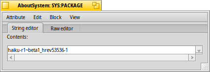

If the file you're probing includes attributes, the menu can be used to open any of them in a new DiskProbe window. Here's the SYS:PACKAGE attribute of the AboutSystem application:
Depending on the kind of attribute, you'll get a different editor tab besides the always present Raw Editor. For example, there are editors for strings and MIME types or an icon viewer for the vectoricon attribute.
