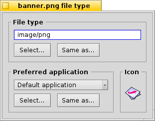

Configurarea tipului de fișier al unui fișier specific
You can change the type of a specific file, its icon and the associated application. Select the file and invoke the from the right-click context menu.
Tipul de fișier
The above is a PNG file, its MIME string image/png. Let's say you definitely know that it's not a PNG but a GIF. You can change that either by entering the correct MIME string by hand or with one of the two buttons below the textbox:
| afișează o listă ierarhică de tipuri de fișier unde navigați la imagine | Imagine GIF. | ||
| deschide un dialog de fișier unde alegeți orice fișier care are deja tipul de fișier pe care îl căutați. |
Aplicațiile preferate
This pop-up menu shows a list of all applications that can handle this particular filetype. From here you can choose which program should open this specific file when it's double-clicked. You could, for example, change a HTML file's preferred application from the browser to a text editor while you're working on it. Every other HTML file still opens in the browser, only this particular one starts in your text editor.
The is the one that's set globally for that filetype. If you don't find the program you want to associate with this file in the pop-up menu, you'll again find the buttons and which do the similar thing described under "The File Type" above.
Pictograma
If you're wondering why the icon well on the top right is empty: Icons are normally inherited from the system default for that filetype. You can open the Filetype add-on of a file that contains an icon and drag & drop it into your file's icon well. Or you double-click the icon well and create or edit your own icon. For more info on icons and how to create your own, see topic Icon-O-Matic.

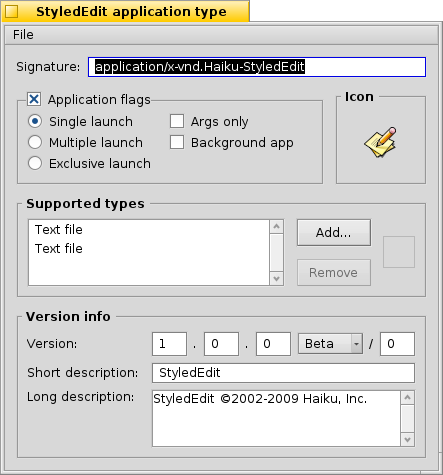

If you invoke the Filetype add-on on an executable (here: StyledEdit), you'll get a different dialog:
On top, you'll see, instead of a standardized MIME string, the unique application signature. With it, the system finds the program wherever it's installed.
Mai jos sunt câteva marcaje, care controlează comportamentul aplicației:
| Only one instance of the app can be running per executable file. If you have two copies of that app, however, they can run side by side. | ||
| Multe instanțe ale aplicației pot rula simultan. | ||
| Really only one instance with that app's signature is allowed to run at a time. | ||
| Indică faptul că aplicația nu răspunde la mesaje. | ||
| The app won't appear in Twitcher or the list of running apps of the Deskbar. |
Then there's the list of supported filetypes. You can add (and remove) filetypes if you think the application can handle them. As a consequence, the app will appear in the menu for preferred applications or Tracker's context menu when you right-click on a file of that type.
At the bottom are version and copyright information. Like the application signature, they are filled in by the app's author and shouldn't be altered.
