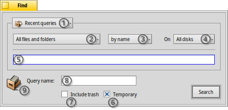

Fereastra Căutare
You start a query by invoking the ALT F. You're presented with the Find window:
menu either from the Deskbar menu or any Tracker window or the Desktop (which is actually a fullscreen Tracker window). The shortcut isSelect recent or saved queries or save the current search parameters as Query Template.
Restrângeți căutarea de la
la tipuri de fișier specifice.- Define the search method:
- - a basic search by file or folder name
- - an advanced search, you specify search terms for one or more attributes
- - an even more advanced search, you can fine-tune a complex query term
Selectați dispozitivele în care căutați.
Introduceți termenul căutat.
Uncheck the
checkbox if you don't want this query self-destruct after 7 days.Verificați dacă interogarea ar trebui de asemenea să
.Opțional, introduceți un nume pentru această interogare dacă vreți să o salvați.
You can drag & drop the icon anywhere to save a query. Doing that with the right mouse button, offers the option to save as template.

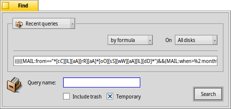

Take the above query by attribute of Clara's mails concerning vibraphones etc. If you have all the attributes and their search terms set, try switching to
mode and be overwhelmed by this one line query string:Încă o dată ca text, editat pentru lizibilitate:
(((((MAIL:from=="*[cC][lL][aA][rR][aA] [oO][sS][wW][aA][lL][dD]*") &&(MAIL:when>=%2 months%)) &&(MAIL:subject=="*[sS][uU][fF][fF][lL][éÉ]*")) ||(MAIL:subject=="*[iI][mM][pP][oO][sS][sS][iI][bB][lL][eE]*")) &&(BEOS:TYPE=="text/x-email"))
Care este utilizarea?
Puteți copia și lipi șirul într-un email, forum sau IRC pentru utilizarea sau depanarea acestuia de către alte persoane.
You can use this method to construct a query in query command in the Terminal.
mode and then switch to mode, to comfortably generate a search string. Enclosed in single quotes, that string can then be used with theYou can fine tune your query by inserting parenthesis where needed, make parts case-sensitive or negate logical combinations by changing. e.g. "==" to "!=" for a NOT AND. All you need is a basic understanding of regular expressions and maybe some scripting basics.
