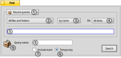

查询窗口
您可以从 菜单,桌面栏菜单,任何文件浏览器窗口,或者桌面(一个全屏的文件浏览器窗口)调用查询。对应的快捷键是 ALT F。它将会呈现如下查找窗口:
The menu allows to an existing query and the current search parameters as a query or Query template. It also gives quick access to .
lets you include the Trash in your search.
holds a list of all query templates on your system.
查询范围从 缩小到特定的文件类型。
- 定义搜索方法:
- - 基本搜索,基于文件或者文件夹名的查询
- - 标准搜索,基于一个或多个属性的查询
- - 高级搜索,基于查询规则的复杂查询
选择所要搜索的目标驱动。
输入搜索词。

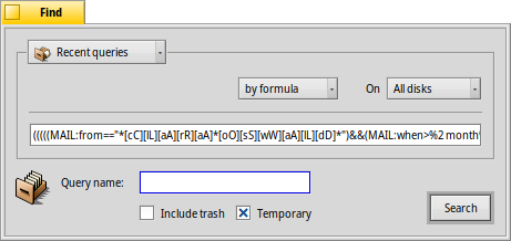

高级查询 - "使用表达式"
手动输入表达式确实让人生畏,并且不切实际。但它仍有自己的用处。
使用属性查询 Calara 的邮件中有关 vibraphones 等内容。如果您设置了所有的属性和它们的搜索项,可以尝试切换为模式,然后淹没于这一行的查询字符串:
一行一段文本的编辑方便于阅读:
(((((MAIL:from=="*[cC][lL][aA][rR][aA] [oO][sS][wW][aA][lL][dD]*")
&&(MAIL:when>=%2 months%))
&&(MAIL:subject=="*[sS][uU][fF][fF][lL][éÉ]*"))
||(MAIL:subject=="*[iI][mM][pP][oO][sS][sS][iI][bB][lL][eE]*"))
&&(BEOS:TYPE=="text/x-email"))
如何使用?
您可以复制粘贴字符串到邮件,论坛及IRC中供他人使用或调试。
You can use this method to construct a query in mode and then switch to mode, to comfortably generate a search string. Enclosed in single quotes, that string can then be used with the query command in the Terminal.
您可以微调查询,在需要的地方插入括号,使某些部分大小写敏感,或者取消逻辑组合,如为 NOT AND 修改 "" 为 "!="。所有您需要的就是基本理解正则表达式,和脚本的基础知识。

If you double click a saved query, the file search is at once started and the result window opens immediately. However, you may not want to search with these exact search parameters, but use it as starting point to only slightly tweak the formula.
By using the menu item (see (1) in screenshot at the top), you can create just such a template. Double clicking it won't open a result window, but the Find panel, giving you the opportunity to quickly change search strings or add/remove attributes.
Wherever you choose to save query templates, they'll be listed in the Find panel's menu.
