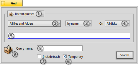

The Find window
You start a query by invoking the ALT F. You're presented with the Find window:
menu either from the Deskbar menu or any Tracker window or the Desktop (which is actually a fullscreen Tracker window). The shortcut is![basic-query.png](images/queries-images/basic-query.png)
Select recent or saved queries or save the current search parameters as Query Template.
Narrow down your search from
to specific file types.- Define the search method:
- - a basic search by file or folder name
- - an advanced search, you specify search terms for one or more attributes
- - an even more advanced search, you can fine-tune a complex query term
Select which drives to search on.
Enter the search term.
Uncheck the
checkbox if you don't want this query self-destruct after 7 days.Check if your query is supposed to
.Optionally, enter a name for this query if you want to save it.
You can drag & drop the icon anywhere to save a query. Doing that with the right mouse button, offers the option to save as template.

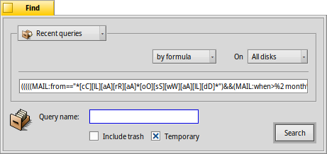

Even more advanced queries - "by formula"
Typing in a formula query by hand is daunting and really quite unpractical. It still has its uses.
Take the above query by attribute of Clara's mails concerning vibraphones etc. If you have all the attributes and their search terms set, try switching to
mode and be overwhelmed by this one line query string:![formula-query.png](images/queries-images/formula-query.png)
Once more as text, edited for readability:
(((((MAIL:from=="*[cC][lL][aA][rR][aA] [oO][sS][wW][aA][lL][dD]*") &&(MAIL:when>=%2 months%)) &&(MAIL:subject=="*[sS][uU][fF][fF][lL][éÉ]*")) ||(MAIL:subject=="*[iI][mM][pP][oO][sS][sS][iI][bB][lL][eE]*")) &&(BEOS:TYPE=="text/x-email"))
What's the use?
You could copy and paste the string into an email, forum or IRC for others to use or debug.
You can use this method to construct a query in query command in the Terminal.
mode and then switch to mode, to comfortably generate a search string. Enclosed in single quotes, that string can then be used with theYou can fine tune your query by inserting parenthesis where needed, make parts case-sensitive or negate logical combinations by changing. e.g. "==" to "!=" for a NOT AND. All you need is a basic understanding of regular expressions and maybe some scripting basics.
