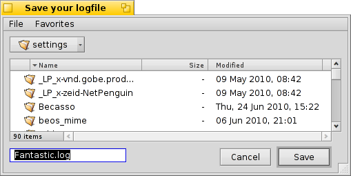

filepanel | filepanel 显示一个装载或者保存文件的面板,并且让用户选择相应的文件和位置。同时您将会获取到一个文件或者文件的路径作为返回值。并且还有几个参数可供使用,例如,设置起始目录,窗体的标题,默认保存的文件名。下面是一个例子: filepanel -s -t "Save your logfile" -d ~/config/settings -n Fantastic.log

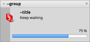

notify | notify shows a notification panel with a message. There are various parameters that are described when you call notify --help. A notification can also be used to show the progress of some action. When doing that, it's important to set a messageID and always use it when you update the progress (a float between 0.0 and 1.0 that's printed as percent). Otherwise you'll see several notification panels if you update quicker then the set timeout. notify --type progress --group "--group" --title "--title" --icon /boot/home/bebook.hvif \ --messageID MyMessageID --progress .75 "Keep waiting"
